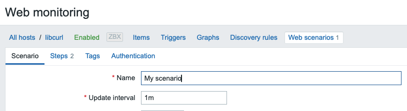

      sorry, I explained myself poorly, my hosts are websites and in zabbix I inserted them only with the web scenario. And now I would like to change their interval.
      • dimir
        Zabbix developer
        • Apr 2011
        • 1080
        It's here:
        • massaia89
          • Feb 2024
          • 10
          Thanks dimir,
          Yes I know, but I want to change it for all my hosts at once.
          thanks again!
          • dimir
            Zabbix developer
            • Apr 2011
            • 1080
            There is no way to do that from Frontend. You can use Zabbix API or perform the change directly in the database (the following SQL query will set Update interval of all scenarios to 1 minute):
            update items set delay='1m' where type=9;
