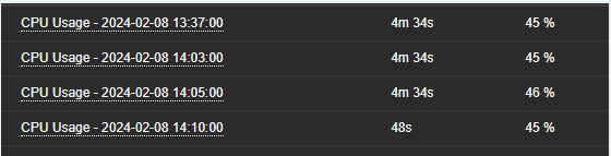

    I have OID that returns the CPU usage value per minute, so the index changes every minute. If I perform a discovery I obtain the item correctly, but I obtain items for every minute. Is it possible to keep only the last value or what would be the correct way to handle these OIDs?

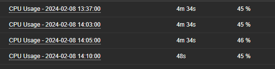

      As you can see, the index changes and with each change a new item is generated in zabbix.

              The problem is that every time the item is discovered, a new one is created, wouldn't it have to do with the key? I use the snmpindex for the key and since it is a different one, another item is created every minute
              Click image for larger version  Name:	image.png Views:	1 Size:	2.3 KB ID:	478735
              I can get the values ​​without problems, but they always get duplicated
              Regards
