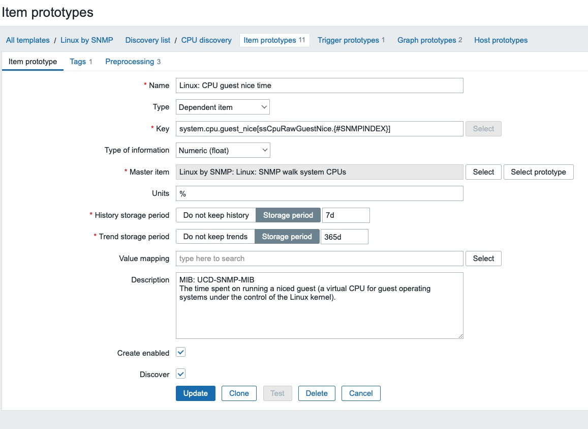

    Baffled at what is causing this issue once SNMP OID Discovery Rule is enabled, although template test was successful. Went over the rule with a fine-tooth comb and compared to out-of-the-box Zabbix discovery rules.
    Additionally I was able to confirm from a test host Latest Value that the SNMP OID values do appear successfully.
    Invalid discovery rule value: cannot parse as a valid JSON object: invalid object format, expected opening character '{' or '[' at:
    '.1.3.6.1.4.1.6431.1.3.7.1.0 = Counter64: 12
    .1.3.6.1.4.1.6431.1.3.7.2.0 = Counter64: 0'​

    Click image for larger version  Name:	Screenshot 2024-02-08 at 8.20.48 AM.jpg Views:	0 Size:	110.2 KB ID:	478669

    Instead of showing item prototype configuration, could you show discovery configuration? And specifically the "preprocessing" tab of the discovery configuration. Based on error text the problem lies there.
    You can double check expected configuration in the documentation.
      missing a walk to json preprocessing?
