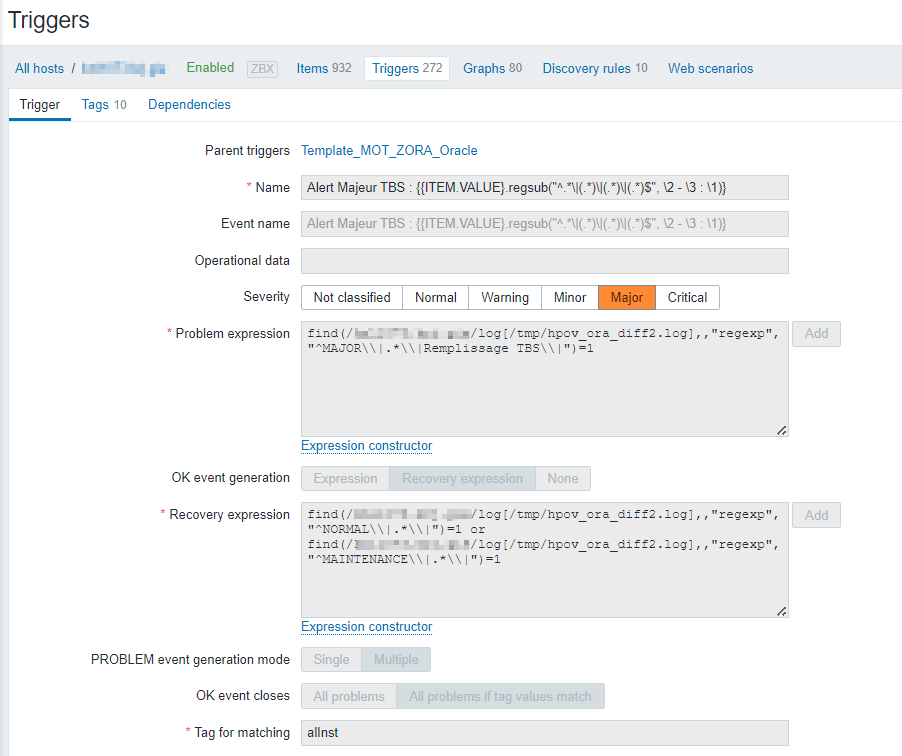

    I have an issue with triggers using the 'find' function with 'regexp' or 'like' operators and a regular expression pattern on Zabbix 6.4.2.

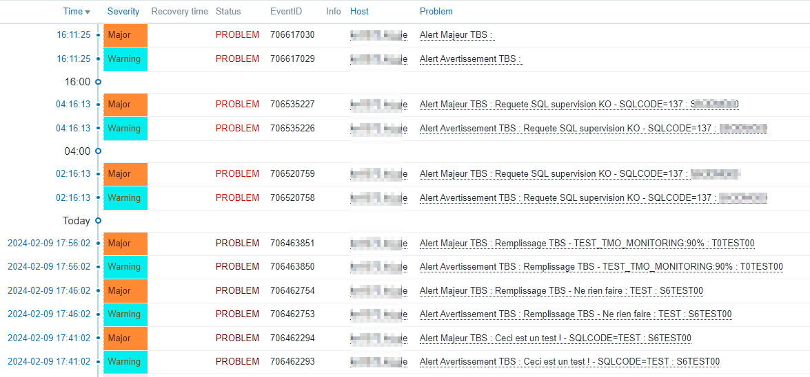

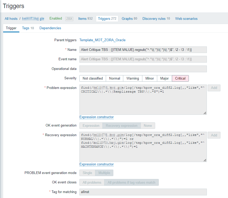

    The ones using the 'regexp' operator (the Warning and Major on the screenshot) fire whatever is in the log file, while the one using the 'like' operator doesn't fire at all, even if the message matches the pattern...
    The recovery expressions don't work either.
    These triggers have been migrated from a Zabbix 5.0 to a Zabbix 6.4.2.
    Is there something wrong with my syntax please ?​

    Hey there.
    The "like" behavior is expected, as it not uses regex pattern but does actual strings comparison of "pattern" and last value.
    Regarding regex match I don't have a Lab currently to do real life test, but have a gut feeling it's related to double backslash of "I". Any reason for that? Likely it ends up as non backslashed "|" character and as such the whole expression boils down to ".*" matching any string checked.
    Per my understanding it should be a single backslash to treat "|" as actual character and not the regexp "or". If there is some limitation in Zabbix web UI that forces you to use double backslash I would go for a "." character instead of "\\|" combination. quick test with regex101.com seem to indicate it should work (https://regex101.com/r/8m9rJW/1)

      Thank you for your answer, I've indeed managed to get around the issue with regexp such as "^CRITICAL.*Remplissage TBS.*$".
      Since it looks like a bug, is there a fix yet or no please ?
        • 4997
        If you consider it as bug you are welcome to submit a report https://support.zabbix.com/browse/ZBX
        But I think your double \\-s in problem expression are the reason its not working, as ISiroshtan already pointed...

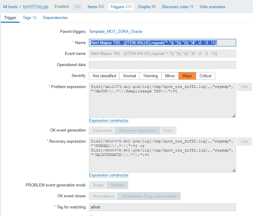

          The double \\-s are placed by Zabbix itself, either when we migrated these triggers from our 5.0 platform and when we use the little "wizard" by clicking the "Add" button next to the expression window (see screenshots below).

          In addition, it seems impossible to use a single \ to escape a special caracter directly in the expression window (see error below) :
          This is why it looks quite like a bug to me.
