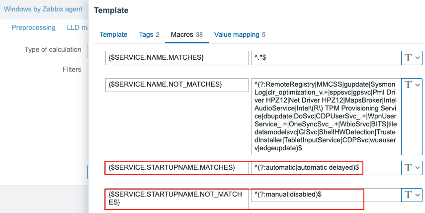

          To me the reason might be that your services are not automatically started (either manually or disabled). Our template only looks for the automatic or automatic delayed services.
Name:	Screenshot 2024-02-13 at 16.53.35.png
          If your service start is manual you can try to create 2 host macros:
          {$SERVICE.STARTUPNAME.MATCHES}=^(?:automatic|automatic delayed|manual)$
          {$SERVICE.STARTUPNAME.NOT_MATCHES}=^disabled$
          Then wait till the next time discovery rule is run (or run it manually) and see if that changes things.

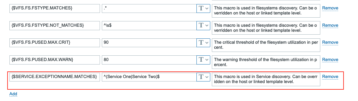

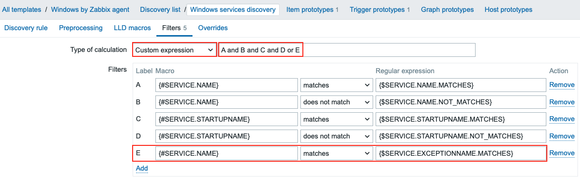

                  One way to overcome this is to edit template Windows by Zabbix agent discovery rule Windows services discovery filters and add filter E and change logic to Custom expression:
Name:	Screenshot 2024-02-15 at 10.41.48.png
                  Then either in template or host add macro:
Name:	Screenshot 2024-02-15 at 10.44.25.png
