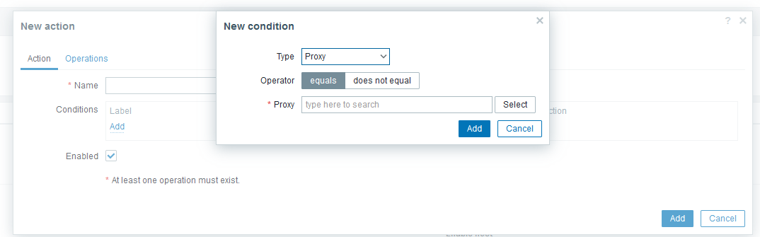

        - To automate onboarding you can create autoregistration action in Zabbix and add condition for a proxy:
        On Operations tab add needed host group and template . Select template according to the agent mode- for Active agents template should contain "Active" suffix. You may need to restart agents to trigger this .

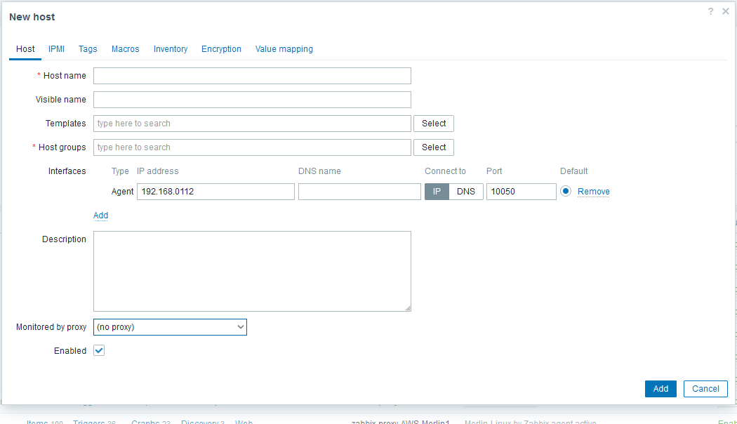

        - Or just add a host manually, specifying local IP as interface IP as it is seen from a proxy and then select a proxy from the list.
