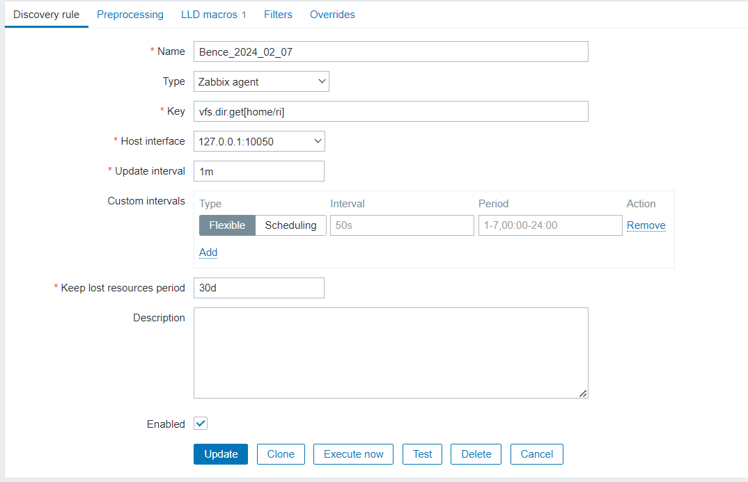

    I have an issue with item discovery. I set up a rule on a server called xy like this:
    The problem is, when i hit the test button, the resulting json contains the directories of the server which zabbix is hosted on, NOT the xy server.

  • Answer selected by kbencze95 at 15-04-2024, 20:41.
    Hamardaban
    • May 2019
    • 2714
    Add or change the ip address of the host itself and it will appear in the selection list for the lld rule
    • Hamardaban
      • May 2019
      • 2714
      Change the ip address in the host interface field to the agent's address. 127.0.0.1 is the local address of the server!
      • kbencze95
        • Feb 2021
        • 18
        Thank you for the answer.
        Sadly, that is the only option under Host Interface field.
        • Hamardaban
          • May 2019
          • 2714
