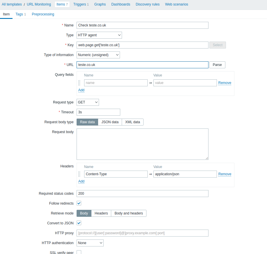

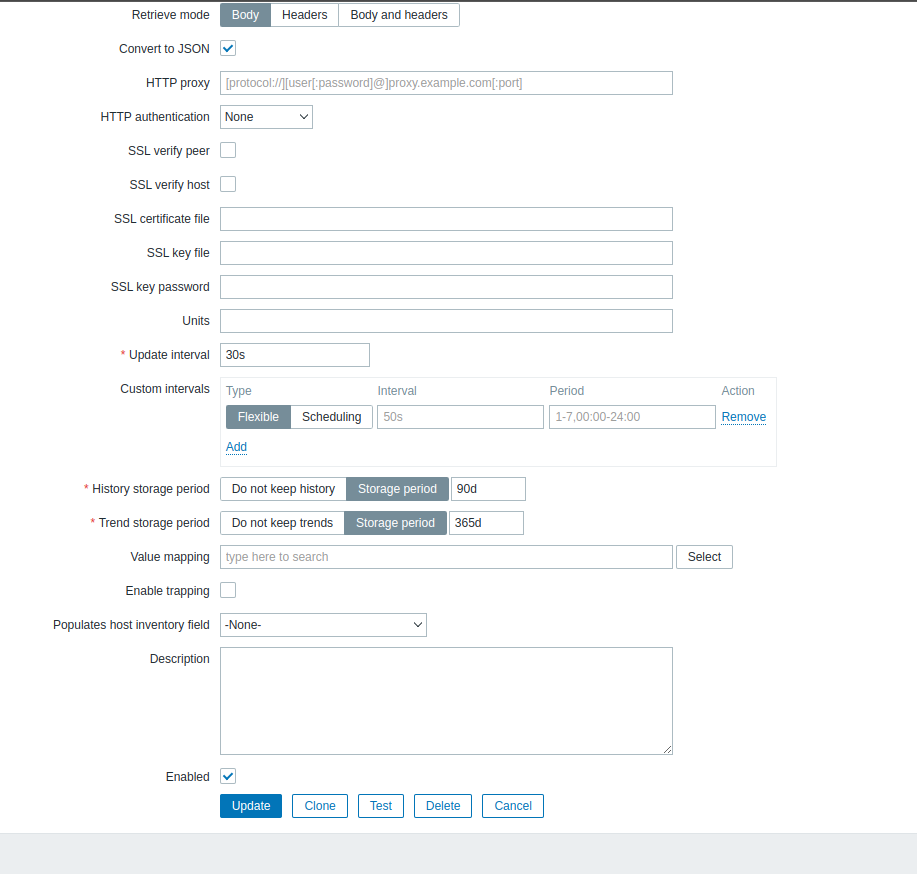

    So, I have a Dev environment with the follow configuration:
    - Zabbix 6.4
    - Ubuntu 22.04
    - 10 hosts: 2 ubuntu and 8 URLs
    My URLs were create using this parameters:
    body:
    jsonrpc: "2.0"
    method: "item.create"
    params:
    name: "Check {{ item }}"
    key_: "web.page.get['{{ item }}']"
    hostid: "{{ zabbix_template_id }}"
    type: 19 # HTTP agent
    value_type: 3 # Numeric Unsigned
    interfaceid: 0 # Não necessário para HTTP agent
    tags:
    - tag: "URL"
    value: "{{ item }}"
    delay: "30s"
    url: "{{ item }}"
    status_codes: "200"
    follow_redirects: 1
    output_format: 1 # Extracted JSON
    posts: ""
    headers:
    Content-Type: "application/json"
    verify_host: 0
    verify_peer: 0
    allow_traps: 0
    auth: "{{ zabbix_api_token }}"
    Where ITEM is an URL; the type is HTTP Agent
    Here we have an example:
    So, it is working when the domain exists, I mean, when it is resolving and it is not returning an error like: "Temporary failure in name resolution". However, How Can I monitor this situation ? When is the domain not resolving ? How could I detect it and create an alert for it ? Is there a way ? Maybe I am using the wrong type to monitor it ?
