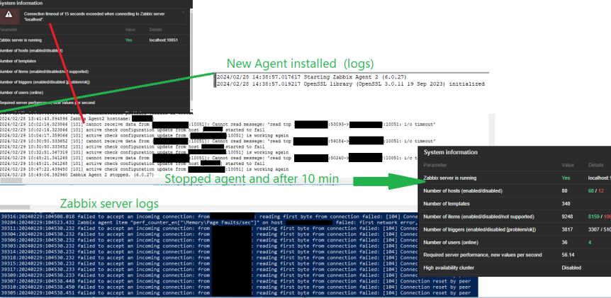

      • AspenKle
        • Feb 2024
        • 12
        Updated to new agent on two hosts that had an issue, agent 2 V.6.0.27. The two agents ran for 1 day, and started to produces errors again.
        After stopping both agents, the Zabbix server was ok after 10 min and inbound flows were normal again.
