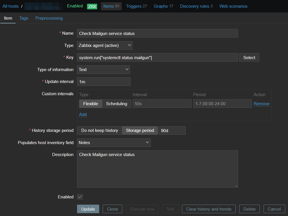

    So we followed an old guide we found but didn't work. We did this:
    First of all, we created an Item with the following values and using 'system.run["systemctl status mailgun"]' key. (We don't know if 'system.run["systemctl is-active mailgun"]' would work too, we don't have preferences, just want it to work any possible way).
    However, it says "Unsopported item key".

    Can anyone help us to monitor a specific service in a host like "mailgun"? We don't know if we were on the right track, so if the way to do this is completely different provide us a new way without any kind of problem.

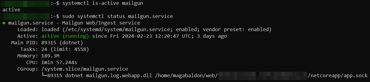

          EDIT: I tried 'system.run["systemctl status mailgun.service"]' which works with Agent1. What's the Expression I should use to create the trigger that will warn me if service is not active?

          EDIT: If I run the following command from Zabbix Server it works, but it isn't working when applied in the trigger, it doesn't give error messages. I try to disable mailgun service to test and it never appears an alert about this on the dashboard.
          zabbix_get -s hostname_example -p 10050 -k system.run["systemctl status mailgun.service | grep 'active (running)'"]
