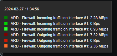

    Hi, i have a template that works (written by someone else), it seems to discover a number of network ports then collects data on each port for sent, receive and errors. If i select the host GRAPH i see 1 graph per entry on each port (in this case 3 graphs for a port, a sent, received and errors).
    When i want to create a dashboard i can only select the line for Incoming or Outgoing traffic (see image), which then adds graph data for ALL the data on that single port so it shows 3 graph lines per port, how would i change the template so i am able to select each data mextric per port in the dashboard graph?
    The image shows (Green) for "Incoming traffic on Interface #1" the 3 entries appear to be discovered by Zabbix as i only see that single entry in the Template coding.... we need to be able to create a graph on a single metric, not all 3. I guess the SNMP scrip looks for how many measure points there are for each port but then doesnt allow me to graph each one separate in the dashboard

    In the used template go to > graph prototypes and edit what you want.
    Based on you current description I can't say anymore about it as the needed information about how the graph is generated isn't mentioned.
