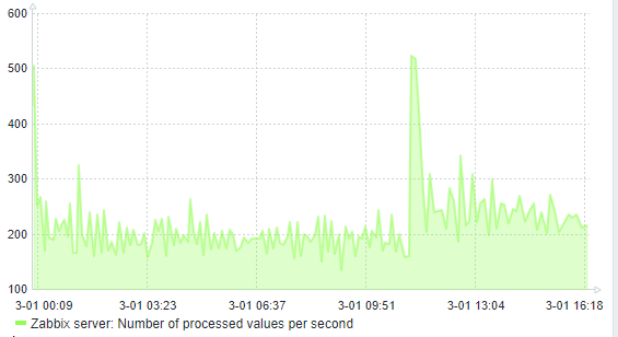

NVPS is too low with MariaDB 10.11 and Zabbix 5.0.41
  • firesh
    • Aug 2021
    • 18
    I have a NVPS of ~200 - 300 which is weird, prior to migrating from MariaDB 10.4 to MariaDB 10.11, our NVPS used to be ~1.2K.
    I am currently using Zabbix 5.0.41 to be specific via containers.
    I have 6794 Hosts, 311258 Number of Items.
    I have 1 Proxy, but the server also receives ~2k of those hosts as part of its passive checks itself.
    I have a server with spec of:
    40 Cores and 377Gb RAM.

    Any help would be greatly appreciated.
    #strugglingsoul
    Have you done some inventory, are all the items still present and receiving data? Specially discovered items... ?
    About your config..
    100 discoverers? Doing some massive network discovery all the time? Looks like overkill and your server also complains about discovery and impossible things...
    100 db syncers? you know that default 4 is OK for 4k NVPS... and after that you add 1 or 2 but not 96... increasing this may do more harm than good...
    10 proxy pollers if you just have one proxy... waste of resources...

      100 Discoverers for now is going by 1 discovery rule = 1 Thread for 1 subnet scan, i already have 42 subnets in list, so approximately 42 threads per that count, hence i just double it and round.
      100 DBsyncers alright this is probably my bad, however this worked efficiently with MariaDB 10.4 and with MariaDB 10.11 it went to shits. So probably MariaDB 10.11 became more efficient ?
      10 proxy poller , well in actual I have 4 proxy, but the rest are just online with just discovery happening, nothing else (almost like abandon), so the logic i was going with was 1 Proxy = 1 Proxy Poller
      Do educate if this thoughts are completely absurd.

          • firesh
            • Aug 2021
            • 18
            This is another thing that is bothering me, why everytime i restart the Zabbix-Server-Mysql (backend of Zabbix)
            For temporary the NVPS will spike high, in this picture is upto 500, i have also seen initially last time was upto 8k,
            but after that it will drop tremendously upto 200 NVPS only.
            It is weird behaviour for the poller, assuming the NVPS count is from the poller.
            Also take note, i have lots of the data coming through SSH Agent and not really Zabbix Agent.
            • firesh
              • Aug 2021
              • 18
              Also another thing that I think Zabbix might not have taken into consideration on the 4k NVPS that you are mentioning,
              that value is assumed that you are using Zabbix Agent as your collector and not SSH agent , isnt it ?
              Have Zabbix ever tested based on their SSH agent, what the nvps they get ?
              I feel like 1000 Poller with SSH agent still seems bottleneck.
                NVPS - Enabled items from monitored hosts are included in the calculation. Log items are counted as one value per item update interval. Regular interval values are counted; flexible and scheduling interval values are not. The calculation is not adjusted during a "nodata" maintenance period. Trapper items are not counted.
                So if your ssh checks are with regular interval, they should be counted...
