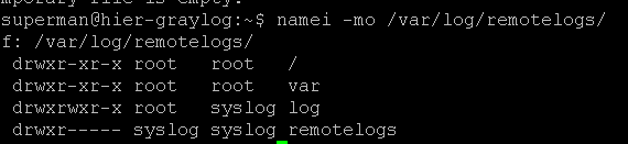

    Your file already has read permissions for all (3x r there). As you list files via sudo, you probably lack some permissions on the directory, where those logfiles are. That "remotelogs" directory.
    Show us out put of "namei -mo /var/log/remotelogs/", if possible
    • conehead
      • Nov 2019
      • 9
      Hi, the result gave me the following
      : Click image for larger version

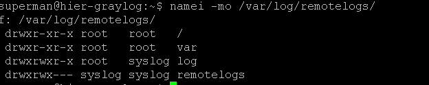

      Now i did an sudo chmod g+wrx /var/log/remotelogs
      result
      But it is still not working and if i understand correctly syslog as a group should have all the rights on that folder

        i restarted the zabbix agent and the results are coming in know
        thanks for the help, i think just the read rights would be sufficient
          To enter a directory and read files from it you need both r and x. so g+rx should have been enough.
