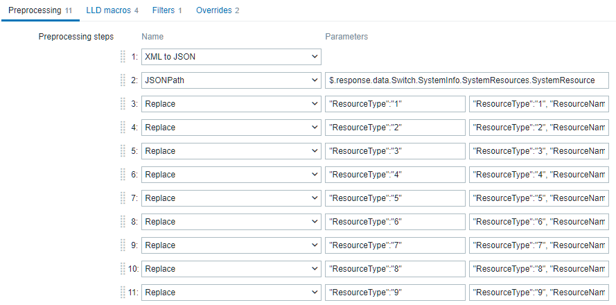

    My workaround is to add the following to Preprocessing:
    The part of the JSON with the ResourceType and it's number is Replaces by itself and the ResourceName.
    But this doesn't scale if there are i.e. 100 types for other values.
      There is no valuemap option to be applied to LLD macros. You can use JS preprocessing and do replacements (or adding additional value to json) there based on your values. After that you can use that LLD macro as you need.
