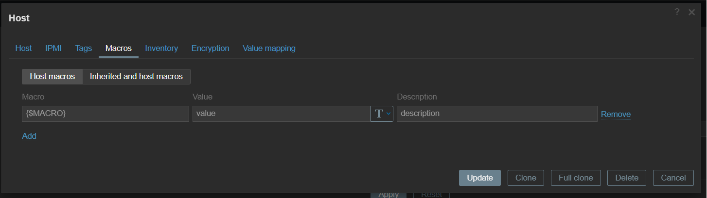

        If you already have added template to a host, you can go to hosts config, Macros section and press "inherited and host macros", you should see those macros now. If you press "change" and enter a new value, you are effectively creating a host level macro with same name and different value. After that it appears also to "host macros". As host level is searched first, value is taken from there and the one from template is ignored.
        If you plan to insert such macros already on autoreg, you just need to know exact macro name and insert it to host config. Later, if viewing over GUI, it will appear same as previously explained under "macros" -> "host macros".

          Oh, from you reply I think I didn't explain myself correctly. I don't want to change the value of the MACRO in the GUI directly in the host, I don't want to do it here
          What I want is that based in some parameter added in the Agent configuration file or in the server itself, that "85" value is sent to the Zabbix Server from the agent, so in that way, I can have 2 different servers with autodiscovery, and each of them sent for example, the Apache port that is configured.
          So server1 would send, for example, "80", and server2 would send "85". That way, the template for both of them is the same and from the agent I can decide to which port should the agent be checking Apache.
          I want that the value APACHE.STATUS.PORT is dynamically set from the Agent, not setting it up in the Zabbix Server GUI
