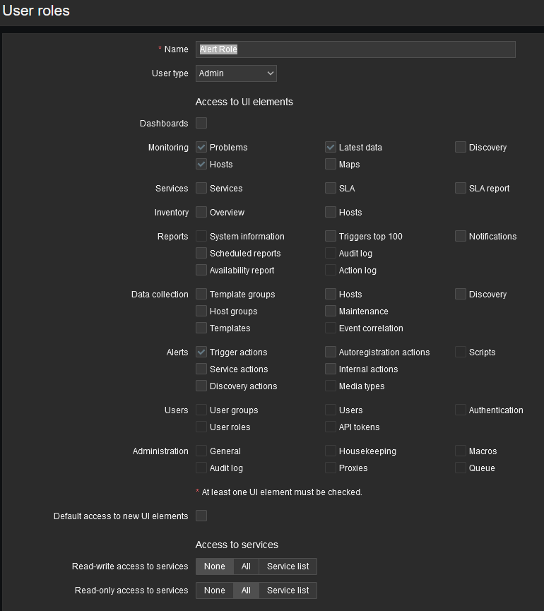

    To support this, I tried to make an extremely limited role for this user called "Alert role". It's a derivative of the "Admin" user type. I gave it all the alert permissions, access to problems modules, and nothing else. I then added the IT.Alerts user to this group.

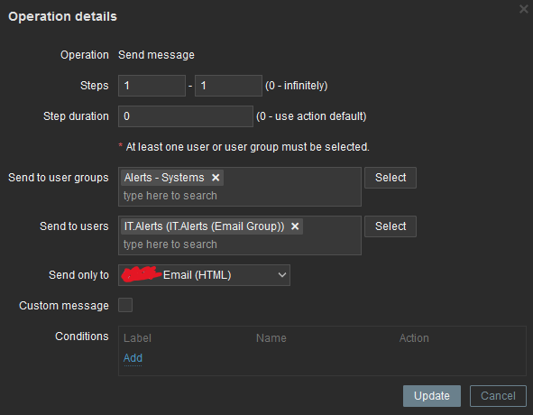

    The operation is to send an email to the IT.Alerts user I created, which is here:
    So, I go and trigger the alert condition. The alert shows up as the correct severity on the problem dashboard, but no action fires, and the Action Log under reports shows no activity.
    My theory is the role is too locked down; what are the minimum permissions I would need to have a role with no access other than to receive email alerts?
    Role does not give permissions to data. Add enough permissions (include that user in required usergroups, which have permissions to right hostgroups) to your user and you will receive your alerts...
    If you log in to Zabbix with your it.alerts user, you shoudl see all the problems there in GUI, if not, you probably do not have enough permissions and alerts also do not work for you.

      That was a great idea, I tuned it and the following gets me emails for alerts, thanks!
