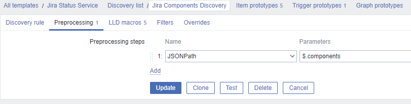

          Hi, thanks for yours answer. I'm trying with @PeterZielony solution.

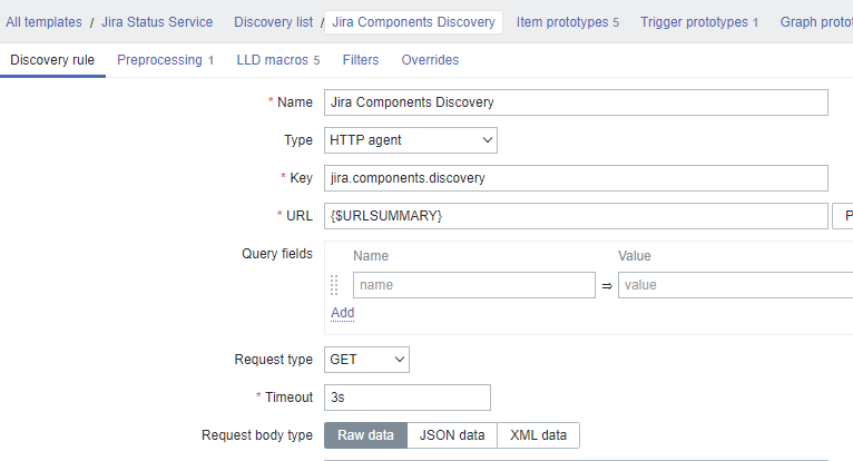

          If can help, here the actual configuration
          Discovery Rule main configuration:
          Click image for larger version  Name:	image.png Views:	0 Size:	25.1 KB ID:	480805
          Actual Preprocessing discovery rules:
          Click image for larger version  Name:	image.png Views:	0 Size:	16.2 KB ID:	480806

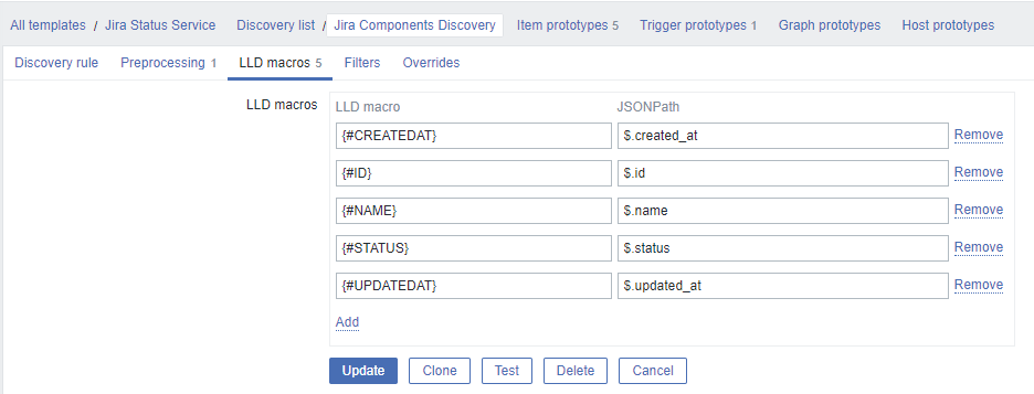

          Actual LLD Macros discovery rules:
          Click image for larger version  Name:	image.png Views:	0 Size:	26.4 KB ID:	480807

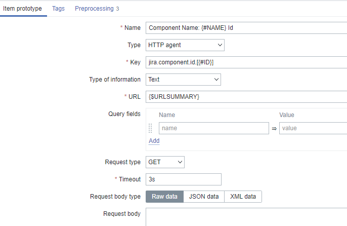

          Main of first prototype configuration:
          Click image for larger version  Name:	image.png Views:	0 Size:	20.8 KB ID:	480808

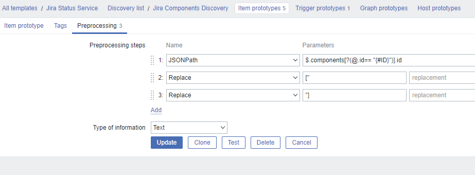

          Preprocessing for first prototype configuration:
          Click image for larger version  Name:	image.png Views:	0 Size:	22.3 KB ID:	480809
          Thanks a lot for new answer

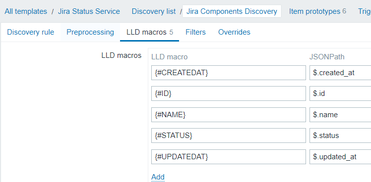

            Than i created discovery rule depends on master item with this LLD macros

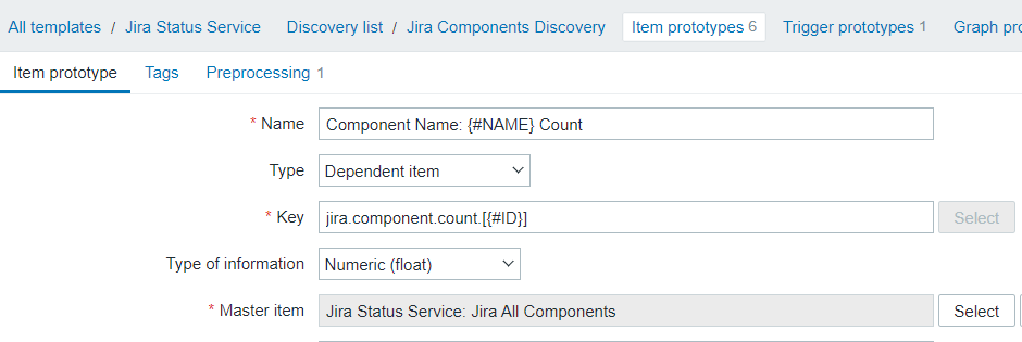

            Then i created prototype item like this with preprocessing jsonpath equal to $.[?(@.id== "{#ID}")].length()

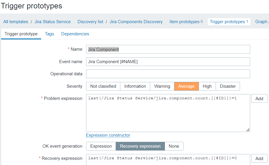

            Then i created trigger prototype like this:

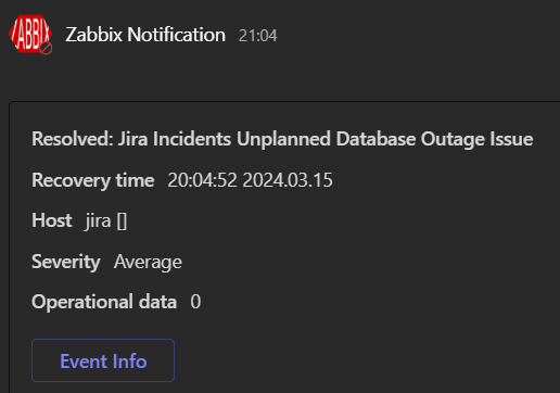

            With this configuration i get this resolved notification
            Do you know how to change "Operational data" value with the value inside LLD macro {#STATUS}?
            Thank you​​​
            • PeterZielony
              PeterZielony commented
              I hope you got it sorted. I wasn't around for some time to check your answer (time off)
            Add {#STATUS} to opdata line...
