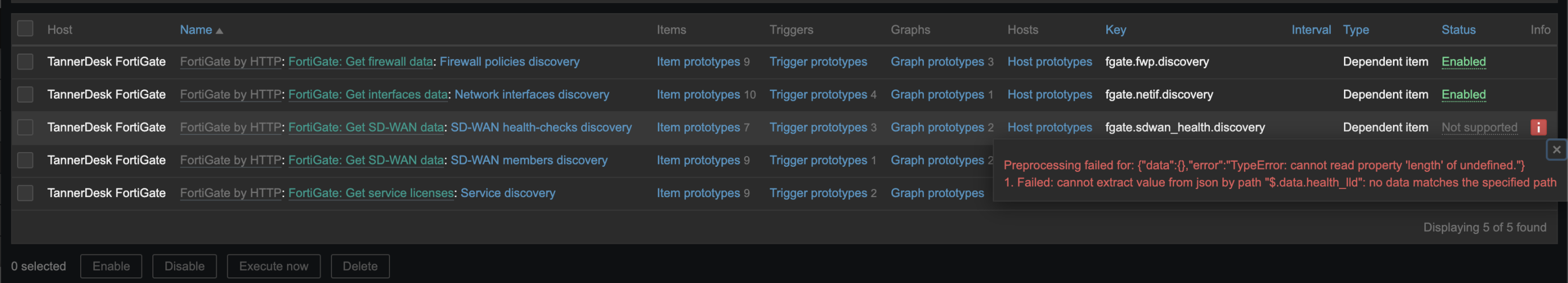

    Hi all!
    We are struggling to get SD-WAN data on our FortiGates. I am running firmware 7.0 and Zabbix 6.4.10. Attached is the error that I am seeing.
    Has anyone successfully been able to get SD-WAN monitoring working on FortiGates?
    Thanks!

    • barzog
      • Sep 2024
      By unknown reasons Discovery rule not working when you configure probe with Participants=All SD-WAN Members. As soon as you put exact members to probe - discovery rule will work OK.
