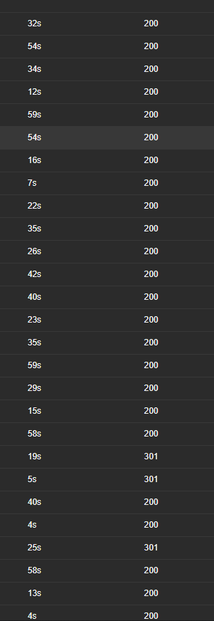

    Hi people!
    I need help in Web Scenarios on Zabbix that i have +1000 web Scenarios but the timeout is not working, i put 5 minutes but the zabbix collect hour by hour:
    How can i resolve this problem involving timeout?

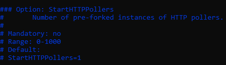

    Do you really expect 1 http poller to satisfy 1000+ webscenarios? Specially with a long timeouts? Why so long timeouts anyway? Normal page should answer in seconds...
    Increase it to 10 at first, look if things get better... if needed add more..

      Hi, where can i find this option ? In my Zabbix proxy ?
      If yes, in my Zabbix proxy is that:

    My HTTPPollers on my Zabbix Proxy:

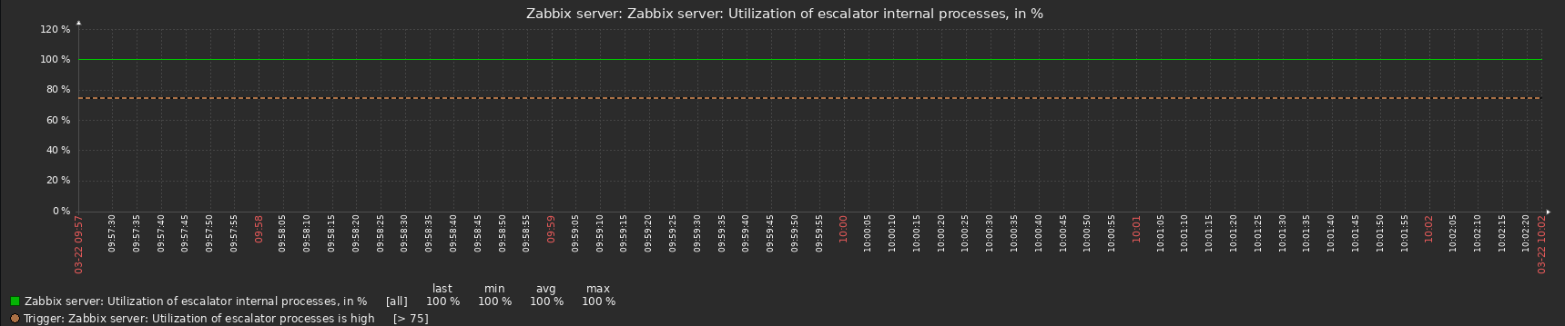

        But my Escalator Internal processes is in 100% yet, how can i resolved this?

          hmm... escalator is a process that deals with escalation of actions... I have never had any issues with that... it rarely gets over couple of %.... Only in case of major alert storms or something... I still have default one escalator process running... You can try to add more, but maybe its worth to increase debug level for escalator process and look what's up there...
