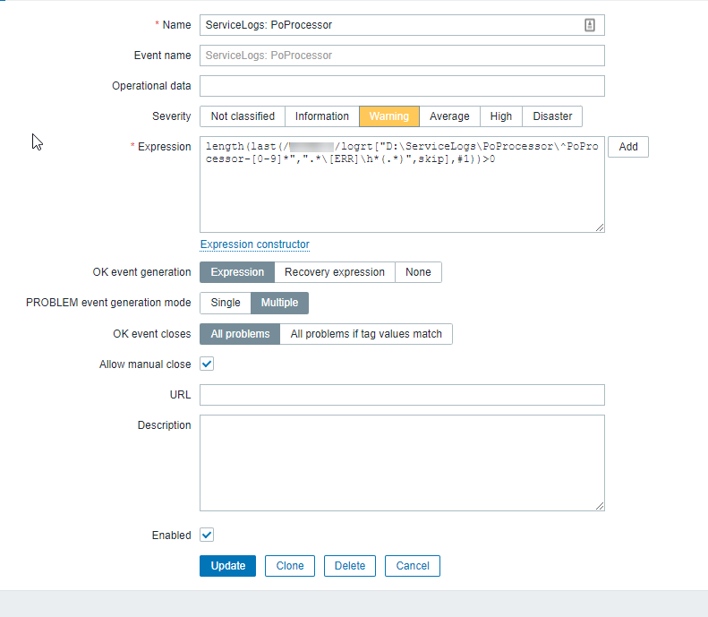

    Sorry if this was asked before but I am new to Zabbix and I am wondering if there is a way to auto close a logrt problem after it sends the email notification about it.
    My config looks like this:
    I have tried what was stated in this article: https://blog.zabbix.com/close-proble...bix-api/12461/ But it doesn't actually close the problem. The one mentioned in the article says it executed the scrip, but it never closes the problem. The webhook mentioned in the comments I also tried and i get this message: error: cannot execute script: cannot close event 262017101: syntaxerror: invalid json (at offset 1)
    So not sure where I am going wrong. I am currently using Zabbix 6.0 if that helps. Thanks

    cyber
    adding " and nodata(/host/item,5m)=0" to expression keeps it in problem state for 5 minutes (after last incoming data). But if it keeps coming and coming and there is no delay, then it most probably will not work out...
    Or add a tag to event and use event correlation, so each new event will close previous one(s). New event tag equals old event tag, or something like that... and "close old events"..

      Thank you so much for the info i was able to find where the event correlation is as i was already Tagging the event. So i configured it to close old events and so far so good.
