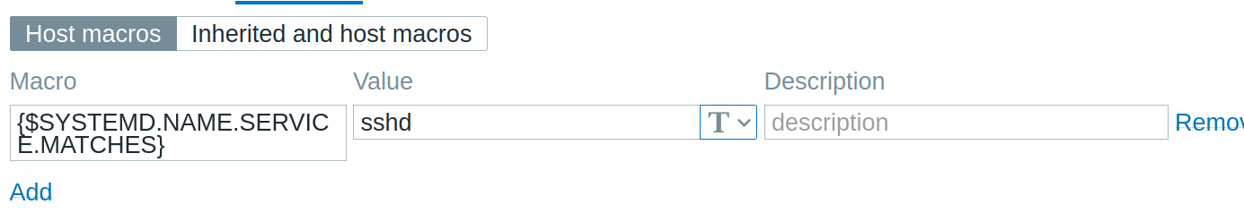

        Hi BigSmooth and thanks for the reply. I am looking at the template now. Would I just change the Value field to what I am wanting to monitor?
        Ok so the answer to that is yes.
        Next question, how does that variable work? Can I just put in something like f* and it will only grab stuff that starts with f? I ask because if I do it this way I am creating about a dozen templates for the services I actually care about.
          yes.. that is treated as regex. If you look into filters part of discovery, then you will find those macros being used there.

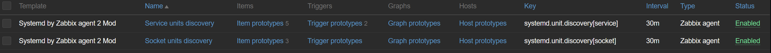

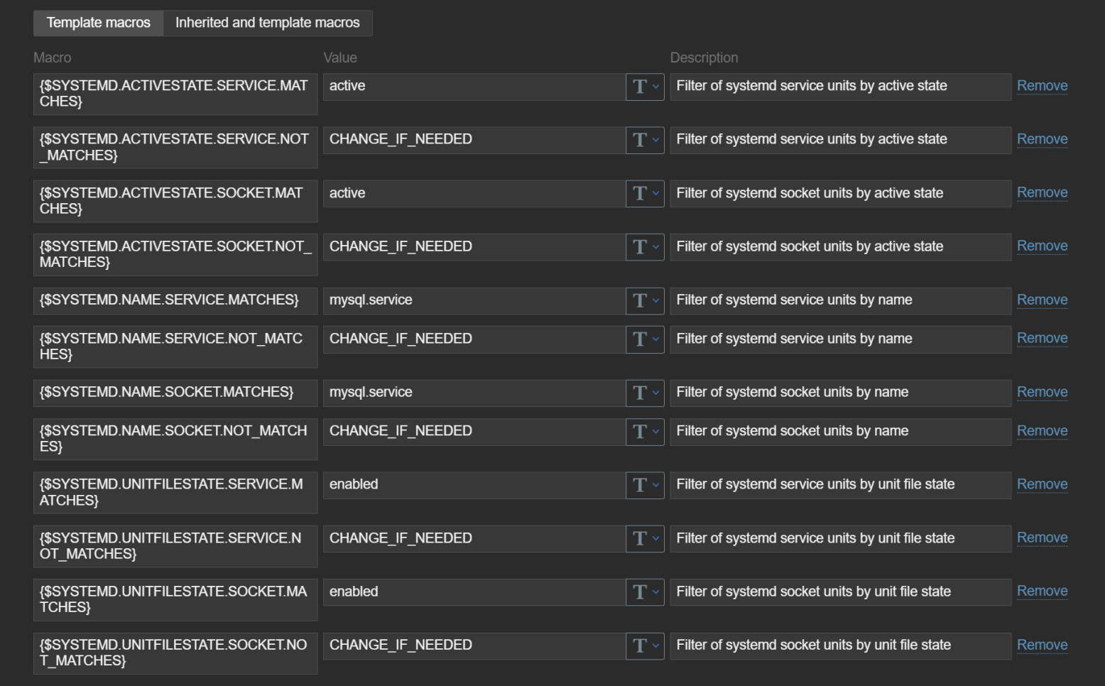

          • pyritejoe
            • Aug 2022
            • 15
            So The first attachment is how I am identifying the service. The second one where is what you are talking about.
