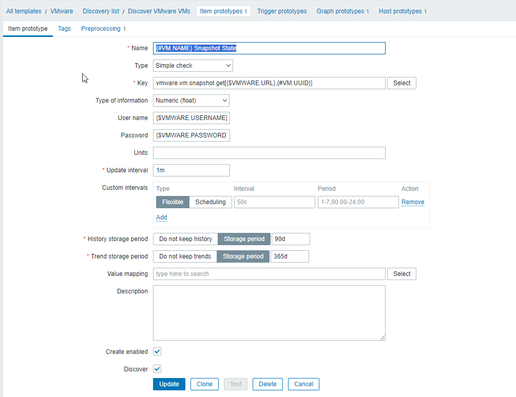

    I Recently added vmware snapshot monitoring to our zabbix server.
    By adjusting the vmware template and adding a LLD item prototype for retrieving the snapshots and returning the $.Count value back.

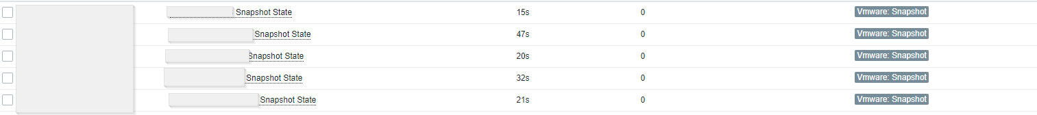

    I am able to return the correct amount of snapshots of a machine, but i'm facing difficulties when trying to pour this into a widget showing me an overview of every machine that has more than 1 snapshot, so we can keep track of these machines.
    i don't find any decent widget that can give me an overview of all the snapshots of those machines. most of the time , i'm only able to select 1 snapshot state for 1 machine. while i want to get an overview of all the machines that might have a snapshot.
    anyone got any experience on this?

    Setup LLD Item prototype

ID:	481856retrieved data which was applied on the vcenter.​
