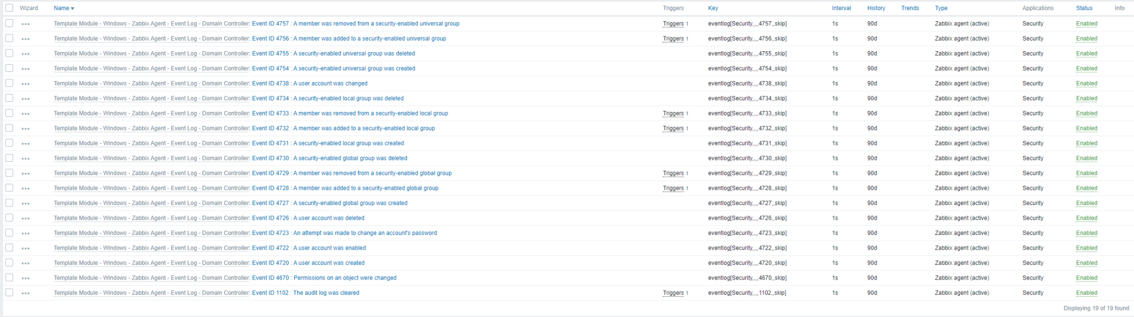

    I have the following items applied to all domain controllers to monitor security events.
Name:	2024-04-05 17_21_03-Window.png

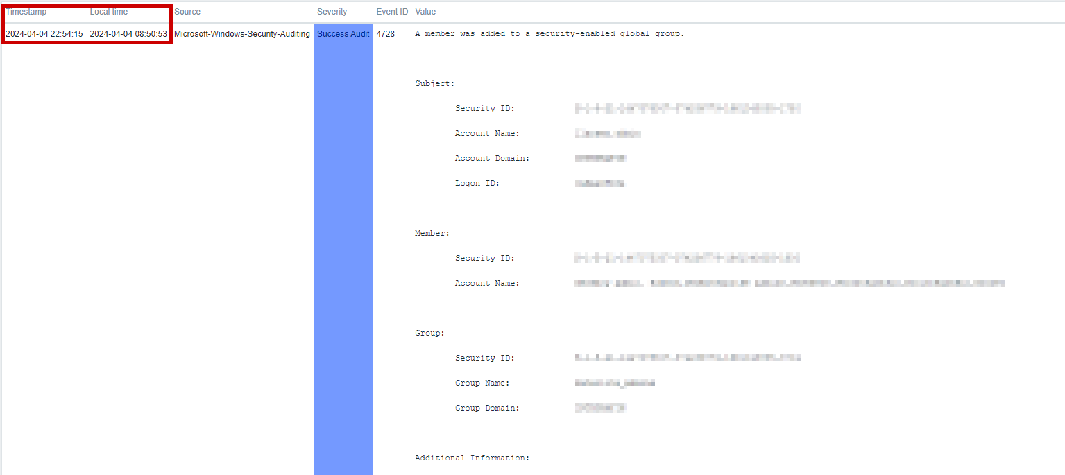

    However the time that the event occurred on the domain controller (Local time), compared to the time Zabbix saw the event is always several hours later. This is causing the alert to trigger way past the event.
Name:	2024-04-05 17_24_28-Window.png
    Here is the domain controllers latest data showing the time it last checked. I assume this is when Zabbix pulled the log and caused the problem alert above.
