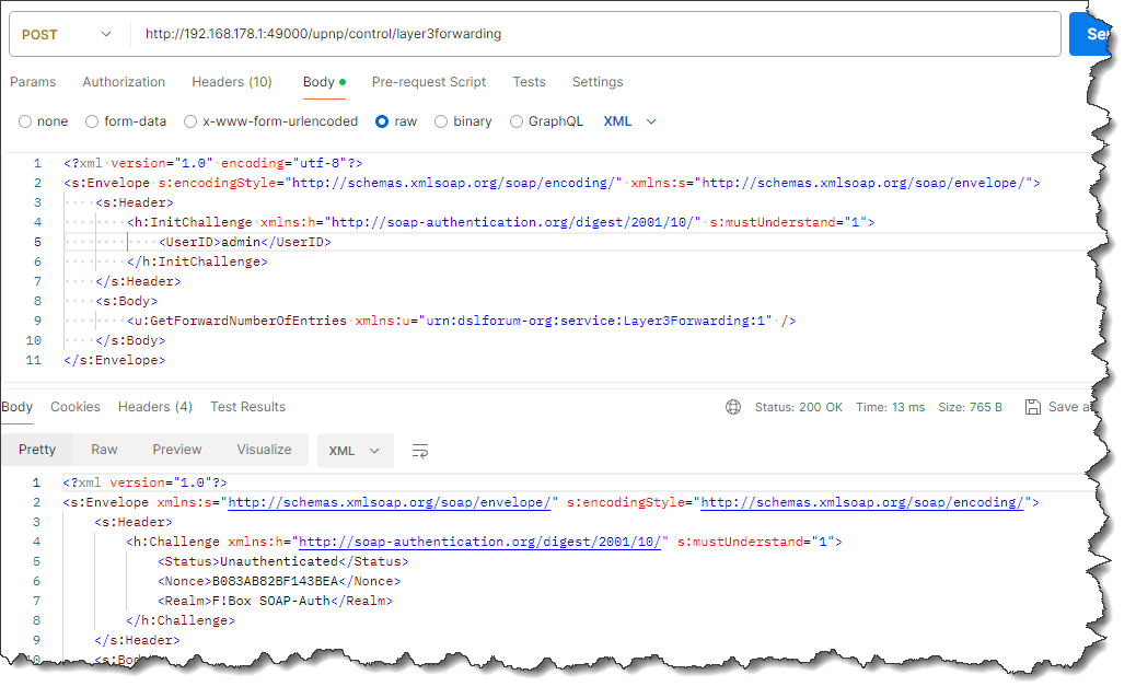

        • Brambo
          • Jul 2023
          • 256
          Are you sure you do a post and not an update towards your device with postman?
          Check the httprequest options and also the log functions to test your script:
          bonus tip: wireshark your postman request and check if maybe your password (not sure if you use in your script) is send over in Base64 or something else, you request http so not that hard to find out

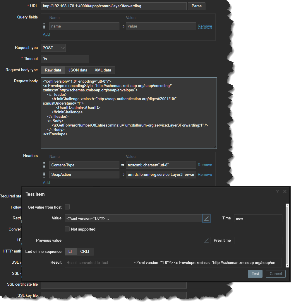

          • DEV2DEV
            • Apr 2024
            Yes - definitely!
            Click image for larger version  Name:	image.png Views:	1 Size:	96.1 KB ID:	482331
            When I create a HTTP-Agent item with POST and the exact same settings, the API works as expected.
            But a HTTP-Agent is not a choice because the API needs a two-step process.
            Question is: What's the difference between the POST of the HTTP-Agent item and the POST in my script?
            Here's the result with the HTTP-Agent:

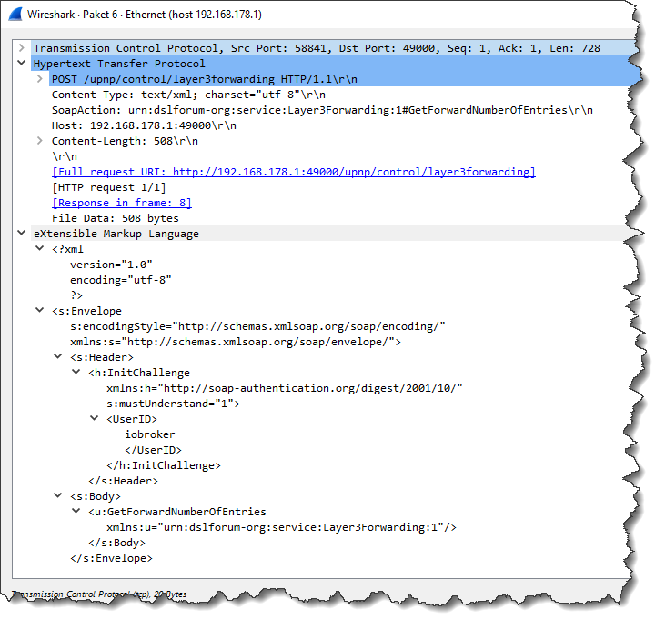

              • DEV2DEV
                • Apr 2024
                Still what are you really sending when you look at the package with wireshark. Postman is showing a lot but it is processed data.
                Postman is exactly sending what I would expect. Not more or less.
                'Wiresharking' Zabbix wil get a little bit complicated, as Zabbix is running as a Docker-Container on Synology.
                Maybe I can extend my test-service to check the headers sent by Zabbix.

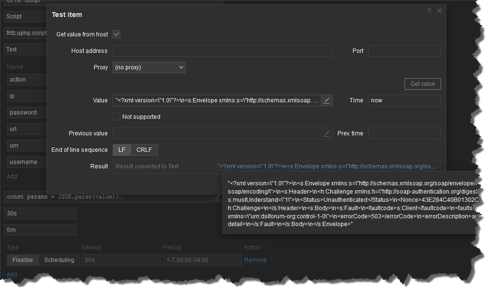

                    • DEV2DEV
                      • Apr 2024
                      Originally posted by markosa
                      How about setting headers like this ...
                      Hero of the day! That's it.
                      Never minded this because there has been no error using two parameters.
