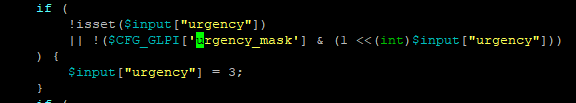

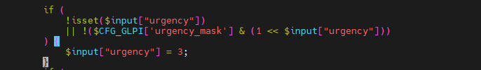

                • davbaq
                  • Jun 2024

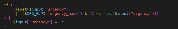

                  Validating error indicates that there is a problem with data type manipulation in the GLPI code. Specifically, you are trying to use the bit shift operator (<<) with a text string, which is not supported.
                  Solution
                  Take backup of the CommonITILObject.php file
                  Review the Code: Open the file mentioned in the error (/GLPI path /glpi/src/CommonITILObject.php) on line 2583 and review the code that causes the error.
                  Adjust the Data Type: Make sure that the variables involved in the operation are of the correct type. For example, if an integer is expected, convert the string to an integer before performing the operation.
                  Valor original
                  Click image for larger version  Name:	image.png Views:	0 Size:	8.1 KB ID:	487325
                  if (
                  !isset($input["urgency"])
                  || !($CFG_GLPI['urgency_mask'] & (1 << $input["urgency"]))
                  $input["urgency"] = 3;
                  Add(int) like this;
                  Click image for larger version  Name:	image.png Views:	0 Size:	8.2 KB ID:	487326
                  if (
                  || !($CFG_GLPI['urgency_mask'] & (1 << (int)$input["urgency"]))
                  Save and restart the web server service
                  With that it already worked for me
                  Click image for larger version  Name:	image.png Views:	0 Size:	64.0 KB ID:	487327​
                  What Did the Original Line Do?
                  1. Existence check: !isset($input["urgency"]) checks if the urgency value is not present in the $input array.
                  2. Validity check: !($CFG_GLPI['urgency_mask'] & (1 << $input["urgency"])) checks if the urgency value is valid based on the configured urgency mask ($CFG_GLPI['urgency_mask']) . The 1 << $input["urgency"] operation shifts bit 1 to the left by the urgency value, creating a specific bit mask for that value, and then performs a bitwise AND operation with the configured urgency mask .
                  Solution
                  The error occurred because $input["urgency"] was not always an integer. The solution involves forcing the conversion of $input["urgency"] to integer before using the bit shift operator. This ensures that the operation succeeds and prevents the type error.
                  Explicitly converting $input["urgency"] to integer ((int)$input["urgency"]) ensures that the bit shift operation executes correctly, eliminating the type error and allowing urgency checking works as expected. This modification is crucial to maintain the robustness of the code when handling different types of data input.​

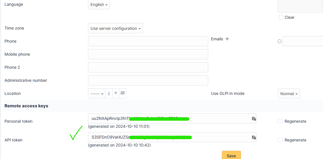

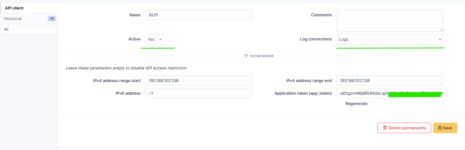

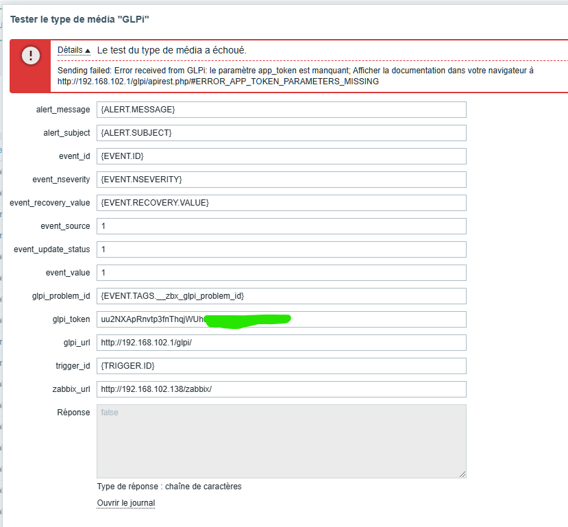

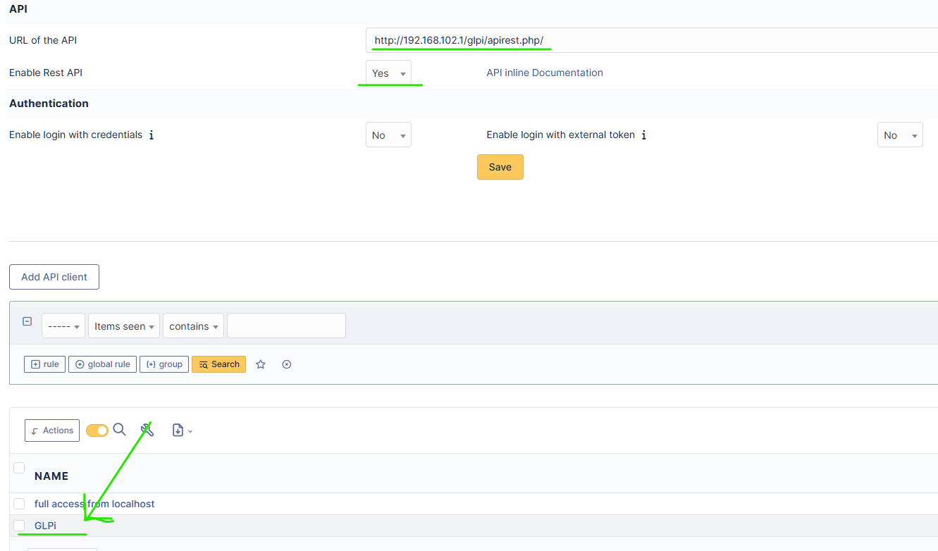

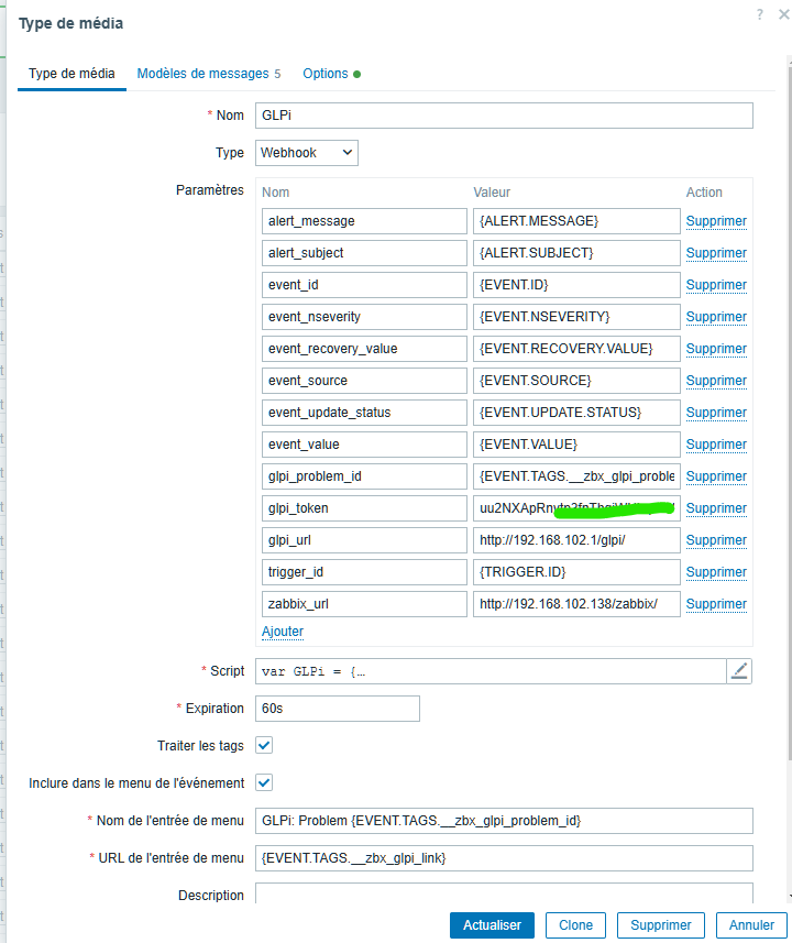

                        • steven b
                          • Aug 2024
                          bonjour á tous !
                          je rencontre aussi un problème toujours le type media Glpi sur ZABBIX en se moment je suis a la version 7.0.4 de ZABBIX et 10.0.6 de GLPI lorsque je configure une erreur persiste et me parle beuacoup de l'app_token manquant. ce pendant j'ai beau activer l'API restfull de GLPI , creer un client API, generer l'le jeton API d'un utilisateur GLPI le copier le coller sur le parametre glpi_token preciser les urls l'erreur reste inchanger j'ai fait des recherches mais je suis un novice dans le domaine de la programmation et pour les API je souhaite que vous eclairez ma lanterne comment devrai-je m'y prends pour que l'utilisateur GLPI que j'ai creer puisse recevoir des notification venant de zabbix. Dans le pieces jointes
