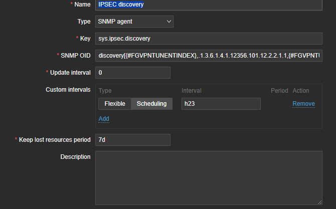

    I am trying to discover IPSEC tunnels from a fortigate and I have an error at the discovery rule level, it states that an item with the same key already exists. However, I've checked the host and cannot find the items.
    I've configured my discovery like this :
    I am basically retrieving the snmp index and the name of the tunnel.

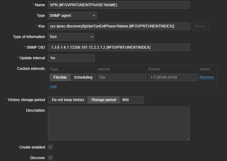

    Then I created this item :
    I ensured to place the snmpindex at the end of the key so I'm sure its unique.
    I also tested the discovery​​, which returns : [{"{#SNMPINDEX}":"1.1","{#FGVPNTUNENTPHASE1NAME} ":" VPN-PA3-PAM94"},{"{#SNMPINDEX}":"2.1","{#FGVPNTUNENTPHASE1 NAME}":"VPN-KEO-VELIZY"},{"{#SNMPINDEX}":"3.1","{#FGVPNTUNENTPHASE 1NAME}":"VPN-MOB-STOUEN"}]

    can you try swapping {#FGVPNTUNETINDEX} with the built in macro {#SNMPVALUE} in the key and OID of your item prototype?
      I also tested the discovery​, which returns :
      Your discovery data does not contain anything like {#FGVPNTUNENTINDEX}, so it is taken literally and you get the same key being created each time... Maybe you should use {#SNMPINDEX} instead?

        It is working properly if I use the built-in macro {#SNMPINDEX}. I had no clue that there was a macro like this, this is fantastic because it makes the discovery rules cleaner and much better to read!
        The weird thing is that for the HA discovery on the same device it was working and returned the proper value but not for the VPNs. Anyway I've replaced all of the index by the macro.
