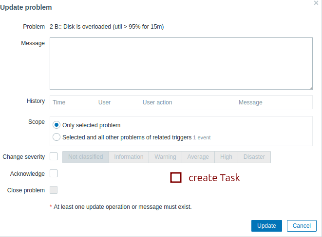

    we want to create odoo tasks (similar to otrs) for important problems.
    I can configure the odoo API via media types.
    However I'm not sure what is the best or simpliest way to trigger the task creation.
    My idea was something like a control field in the problem acknowledge window.
    Maybe there are solutions without developer needs.

    cyber
    • 4961
    Not through that ack window... You can add a script (Administration-> scripts) which can be executed from the menu that opens if you click on problem name... Theres even separate type "manual event action"...

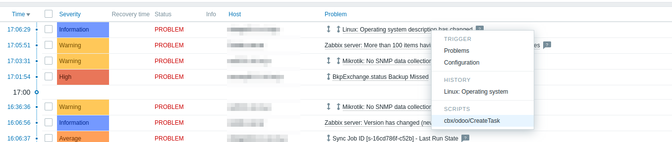

      • cbx-joswei
        • Apr 2024
        Thanks a lot, as always very simple, if you know it :-)
        There is even no need to create the menu entry, this is done automatically.
