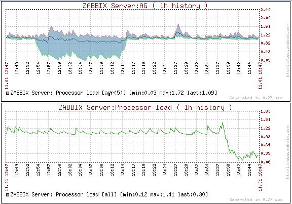

      Bump.. I hate to be a butt on this, but I'd really like to understand the aggregated graphs better.
      For instance the following is a graph I created for processor load. I'm still kinda scratching my head to understand what it's showing me. I know this may seem like a silly question to some, but I know I'm not the only one who's scratched my head on this one, and the documentation is almost non-existant and overall there's little description about this graph type in the forum.

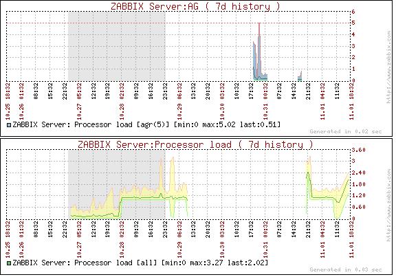

            Ok I get that, but I'm still not quite understanding what the graph is aggregating.
            Is it aggregating n number of periods of the graph? Example if the graph is 1 hour, then it will aggregate the last n hours? Here's a strange one from my development box, it's over 7 days. Again the top is the aggregated one the bottom is the real values (simple graph). Why do I show aggregated data when I don't have real data in that time area and vice versa? I also show a similar situation on a 24 hour graph.
              When selecting a long period, a single pixel (X axis) of the graph represents 10 minutes, maybe 2 days, depending on the period. The graphs displays min, max, avg value for the 10 minutes (2 days, whatever).

                Ok so as I understand it you are saying that the "aggregation window" or the period for which data aggregation is done is determined by the graph period. The smallest the window can be though is 10 minutes. Correct?
                Would the last graph I presented be correct and expected? I ask this because the aggregation shows up in areas where there is no physical data. The data gap was from when the development VMWare image was shut down.
                  Just wondered about the same question. What exactly does type "aggregated" for an item in a graph mean?
                  It seems to be a means to compare values of the current period (displayed in the graph) with min/avg/max from overlapping periods before (and excluding) the current period displayed (which explains, why you see aggregated data although your agent didn't run at all... ).
                  It only makes sense if you want to compare the current data with periods before that or if you want to get an, well, aggregated overview of the data over the last eg. 5 (default) days or weeks.
