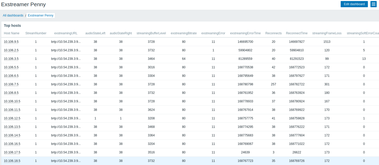

    • Giacomo
      • Dec 2020
      • 14
      Hi Brambo,
      thanks for answering... I try to explain better using my Dashboard (below).
      Here are reported my hosts.
      I want to count how many hosts have the key StreamNumber = 3.
      I've tried with Aggregate Functions with no luck.

      • Brambo
        • Jul 2023
        • 256
        I understand what you want.
        And this is maybe possible when the items are discovered by LLD, not sure though.
        As the item count function cant filter on item value, but it can on tags.
        What you could test in a LLD rule is to set the item TAG with a value. Then you could write the calculated item with ?[tag="tagname:3"] I'm only not really certain if the tags are overwritten every time.
        Otherwise triggers is the route to go but then you can only show it as a problem and I guess you are not looking for that.
