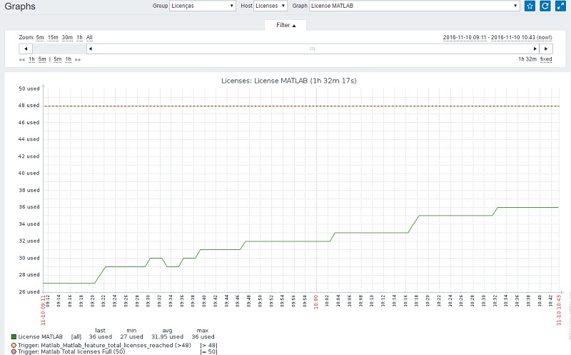

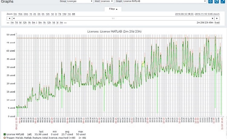

    I recently found out that I had items with the value 0d (trends) and 90d (History). This makes me only see data up to 90 days on graphs.
    These items were added +5 months ago.
    Therefore, I changed the trends from 0 to 365 days and now I only get data of the last 1 hour.
    So I changed back to 0 days and I can see the last 3 months(90d) again.
    Is there a way I can see my last 90 days and new data using 365d on trends?
    Thanks.
    Attached 2 screenshots (trends 0 days and trends 365 days)

      The strange part is that I can still see older data, but for that I have to change the item trends back to 0d (original config). So it didn't delete the history (90d)
      Yes yes I know that the trends should be longer than the history but at the time I created it wrong.
      I'll keep the new item configuration (365d) as it's more future proof.
      before:
      trends:0d - history:90d - I see a maximum of 90d of data
      Now:
      trends:365d - history:90d - I only see new data (that will grow with time)
