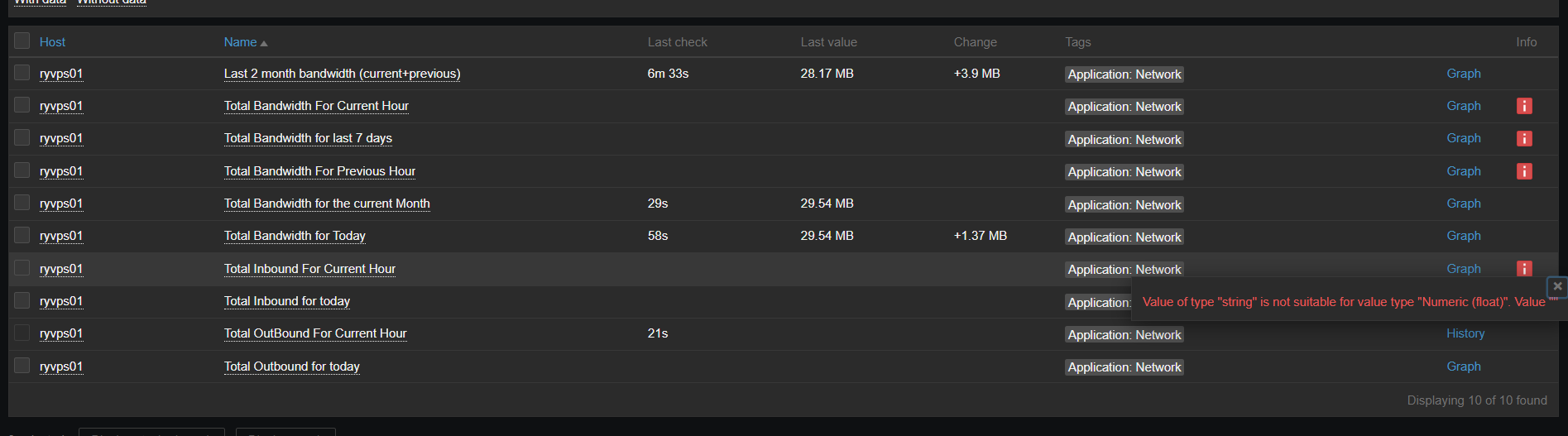

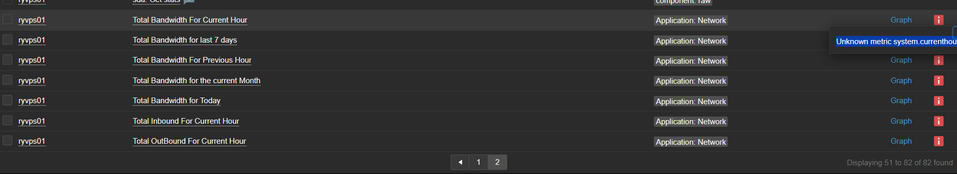

    I am trying to monitor my vps bandwidth using vnstat but I setup it and import template and link it but the latest data showing error Unknown metric system.currenthour
    please check the attachment
  • islam
    • Apr 2024
    • 19
    update please check attachment

        First about unknown parameter... Have you defined your userparameters for this "system.currenthour" parameter?
        Second one suggests, that you do not get numeric (float) values from agent but string...
        I'm not familiar with vnstat output... What this line should do "o=$tempout1$tempout2" Concatenate 2 strings? numbers? And then you calculate something based on that? Maybe you do get error message as a result ...

          I just downgrade the version and result is showing fine thank u
