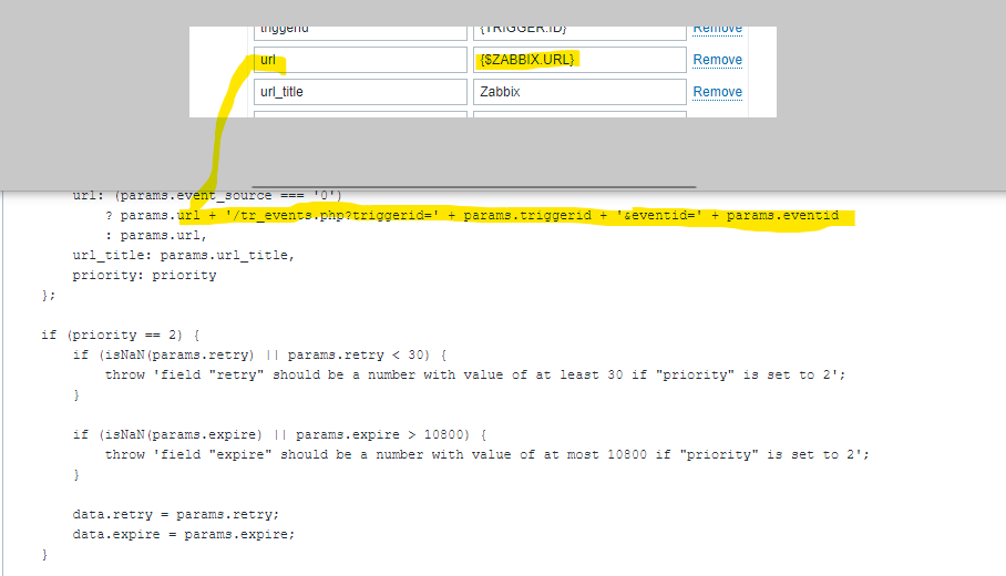

                Looking at the default pushover media type the trigger.url should be atleast something like:
                so zabbix URL/tr_events etc etc. If you get something else i think you change things away from default.
                You could change the media type and add Zabbix.log lines to troubleshoot.
                • barannikov
                  • Jun 2023
                  Thank you for looking into it. My url pushover media variable was missing, leaving only url_title variable, thus causing unclickable wrong link in the end of every message. Thanks a million!
