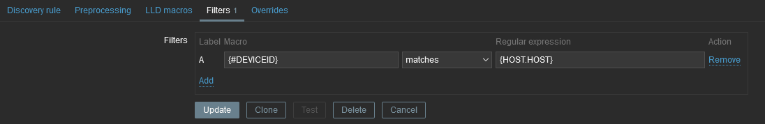

    - Use discovery rule with the previous item to generate a host for each one of the components and assign them another template for discover each characteristic of the json and filter the response to match only the actual host id.
