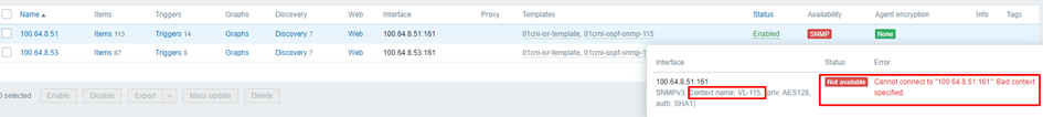

    Hello!
    My goal: read multiple OSPF tables using snmp-context per process.
    I setup discovery rule + action and find my devices added with no snmp context.

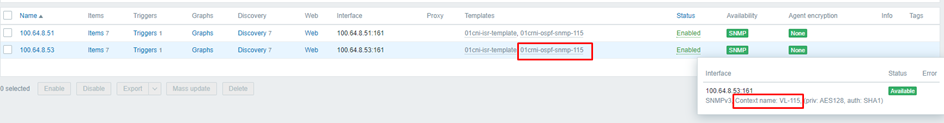

    Then i have other discoverys of just OSPF for devices that has it running, one per instance using specific contexts.

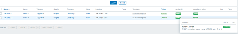

    And then an action to apply my templates for OSPF to OSPF devices.
    Now the problem i face - it will update existing SNMP configuration and add the first discover that passed filling in that checks context.
    This obviously not only breaks some checks but also will never work when i need multiple contexts OSPF pulling.
