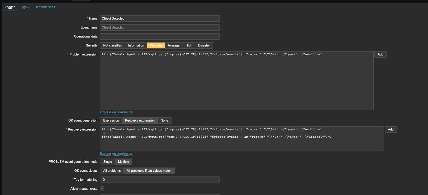

    The trigger I have created so far:

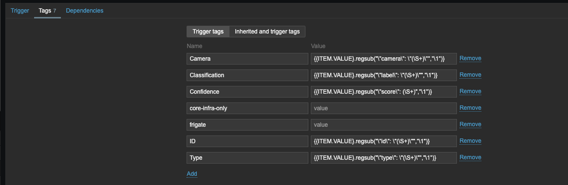

ID:	484836​The Tags are:
    The logic I am looking for is along the lines of "open a new problem every time an event of type new comes in. I want to then close it when either a corresponding event of type end comes in, or no update events have been received for two minutes.
    The event creation appears to be working just fine (every new event creates a problem) and the closing when an end event comes in appears to be working just fine. However, the logic for "close events if no update has been received for two minutes does not. I have that logic because if the server reboots, it stops and removes all events that are active (and does not send an end for them). Therefore I want zabbix to assume the event has ended if it stops receiving updates. This could also happen if I just happen to miss the end message and I don't want the problems to stay open indefinitely because the update messages will keep coming if the event is still open.
    To try and troubleshoot, I used a calculated item to test the recovery expression against my data and the responses from it seem to line up with this working. However, problems just will not close if they don't receive an end message.
