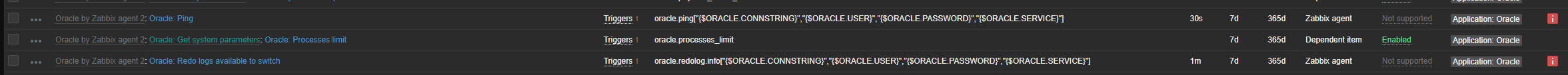

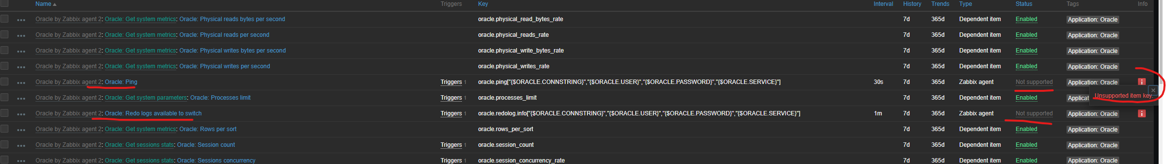

        ScreenCap of the issue

              it appears i am using zabbix agent
                From that picture you cannot determine, what agent type you have. "Zabbix agent" in that picture refers to check type (passive check). Why I think you have wrong type is because those item keys should be built in to agent2, if you see an error "unknown item key", then you most probably have wrong agent type installed.
                • mathisreel66
                  • Jun 2024
                  • 19
                  yea you are right. i was using an older agent. I have updated the agent to agent2 and it is working. thanks for the help
