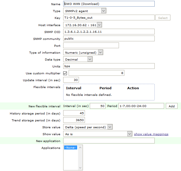

    Last week, we started using 10Gbps SFP module with optic.
    At this time, traffic is between 0,6 - 1,4 Gbps. But there is problem with zabbix. Zabbix configurarion is attached bellow as image. Problem is also shown on attached picture - when traffic Raise up to ~1,2, zabbix start storing bad history :/
    Can somebody help me to solve this problem ?
    Thank you

    Please try change from IF-MIB::ifOutOctets to IF-MIB::ifHCOutOctets?
    OID:
    from
    .1.3.6.1.2.1.2.2.1.16.11
    to
    .1.3.6.1.2.1.31.1.1.1.10.11
    IF-MIB::ifOutOctets is 32bit Counter.
    In a high-speed network, overflow of digits occurs immediately.
