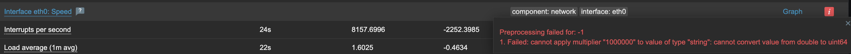

            • whanklee
              • Dec 2019
              • 19
              Hi there,
              I checked that JIRA ticket, however, the error is still there, the error has not been resolved for me.
              Zabbix version 7.0.6
              Any idea?
