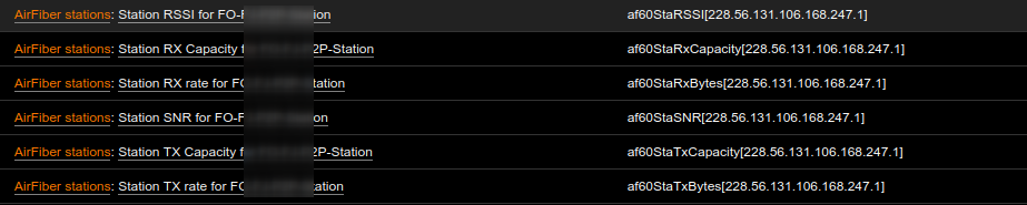

        Never mind....I was over-thinking this. The many extra numbers in the OID aren't a problem:
