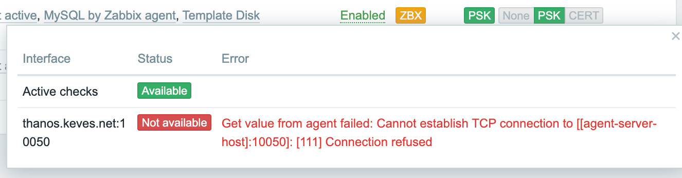

        I upgraded Zabbix from version 6.4 to 7.0. The active and passive Agent worked with the previous version, but since upgrading I always receive an error and I am unable to start Agent.
        Architecture:
        • Server A named Zabbix server (DNS ultron.xxxxxx.xxx): Zabbix server and 1 active and passive Zabbix Agent
        • Server B named Thanos (DNS thanos.xxxxxx.xxx): 1 active and passive Zabbix Agent
        • Operation system version Ubuntu 22.04
        • PostgreSQL 16
        The Agent installed on the Zabbix server is working, and there is no any problems on that server; both active and passive checks are working well.
        However, on 'Server B' named Thanos, only the active check works. The Zabbix server cannot reach the Agent on port 10050 because it constantly stops. Interestingly, if I stop the Zabbix server and restart the Agent on Thanos, it starts, but as soon as the Zabbix server is restarted, the Agent immediately stops with an error code.
        I did not change the configuration after the upgrade; it worked with this configuration previously. I cannot figure out what might be causing the error.
Name:	get-value-from-agent-failed-cannot-establish-tcp-connection-v0-tj0nce54iq6d1.webp

        2229260:20240615:150124.530 ====== Fatal information: ======
        2229260:20240615:150124.530 Program counter: 0x5629c04224d0
        2229260:20240615:150124.530 === Registers: ===
        2229260:20240615:150124.530 r8 = 5629c14b90c0 = 94737336602816 = 94737336602816
        2229260:20240615:150124.530 r9 = 0 = 0 = 0
        2229260:20240615:150124.530 r10 = 7f211afcfac0 = 139780163435200 = 139780163435200
        2229260:20240615:150124.530 r11 = 246 = 582 = 582
        2229260:20240615:150124.530 r12 = 0 = 0 = 0
        2229260:20240615:150124.530 r13 = 7ffefda059f0 = 140733153565168 = 140733153565168
        2229260:20240615:150124.530 r14 = 0 = 0 = 0
        2229260:20240615:150124.530 r15 = 5629c14b90c0 = 94737336602816 = 94737336602816
        2229260:20240615:150124.530 rdi = 1a40032 = 27525170 = 27525170
        2229260:20240615:150124.531 rsi = 0 = 0 = 0
        2229260:20240615:150124.531 rbp = 0 = 0 = 0
        2229260:20240615:150124.531 rbx = 5629c047b051 = 94737319571537 = 94737319571537
        2229260:20240615:150124.531 rdx = 0 = 0 = 0
        2229260:20240615:150124.531 rax = 8 = 8 = 8
        2229260:20240615:150124.531 rcx = 7f211af393eb = 139780162819051 = 139780162819051
        2229260:20240615:150124.531 rsp = 7ffefda059e0 = 140733153565152 = 140733153565152
        2229260:20240615:150124.531 rip = 5629c04224d0 = 94737319208144 = 94737319208144
        2229260:20240615:150124.531 efl = 10202 = 66050 = 66050
        2229260:20240615:150124.531 csgsfs = 2b000000000033 = 12103423998558259 = 12103423998558259
        2229260:20240615:150124.531 err = 4 = 4 = 4
        2229260:20240615:150124.531 trapno = e = 14 = 14
        2229260:20240615:150124.531 oldmask = 0 = 0 = 0
        2229260:20240615:150124.531 cr2 = 0 = 0 = 0
        2229260:20240615:150124.531 === Backtrace: ===
        2229260:20240615:150124.532 11: /usr/sbin/zabbix_agentd: collector [processing data](zbx_backtrace+0x52) [0x5629c043e482]
        2229260:20240615:150124.532 10: /usr/sbin/zabbix_agentd: collector [processing data](zbx_log_fatal_info+0x145) [0x5629c043e6c5]
        2229260:20240615:150124.532 9: /usr/sbin/zabbix_agentd: collector [processing data](+0x58f2a) [0x5629c043ef2a]
        2229260:20240615:150124.532 8: /lib/x86_64-linux-gnu/libc.so.6(+0x42520) [0x7f211ae53520]
        2229260:20240615:150124.532 7: /usr/sbin/zabbix_agentd: collector [processing data](collect_stats_diskdevices+0x40) [0x5629c04224d0]
        2229260:20240615:150124.532 6: /usr/sbin/zabbix_agentd: collector [processing data](zbx_collector_thread+0xc3) [0x5629c0420dd3]
        2229260:20240615:150124.532 5: /usr/sbin/zabbix_agentd: collector [processing data](zbx_thread_start+0x24) [0x5629c043b614]
        2229260:20240615:150124.532 4: /usr/sbin/zabbix_agentd: collector [processing data](MAIN_ZABBIX_ENTRY+0x52d) [0x5629c0403add]
        2229260:20240615:150124.532 3: /usr/sbin/zabbix_agentd: collector [processing data](main+0x33c) [0x5629c04019dc]
        2229260:20240615:150124.532 2: /lib/x86_64-linux-gnu/libc.so.6(+0x29d90) [0x7f211ae3ad90]
        2229260:20240615:150124.532 1: /lib/x86_64-linux-gnu/libc.so.6(__libc_start_main+0x80) [0x7f211ae3ae40]
        2229260:20240615:150124.532 0: /usr/sbin/zabbix_agentd: collector [processing data](_start+0x25) [0x5629c0401a85]
        2229260:20240615:150124.532 === Memory map: ===
        2229260:20240615:150124.532 5629c03e6000-5629c03ff000 r--p 00000000 fc:02 5317 /usr/sbin/zabbix_agentd
        2229260:20240615:150124.532 5629c03ff000-5629c0475000 r-xp 00019000 fc:02 5317 /usr/sbin/zabbix_agentd
        2229260:20240615:150124.532 5629c0475000-5629c049d000 r--p 0008f000 fc:02 5317 /usr/sbin/zabbix_agentd
        2229260:20240615:150124.532 5629c049d000-5629c049f000 r--p 000b6000 fc:02 5317 /usr/sbin/zabbix_agentd
        2229260:20240615:150124.532 5629c049f000-5629c04a1000 rw-p 000b8000 fc:02 5317 /usr/sbin/zabbix_agentd
        2229260:20240615:150124.532 5629c04a1000-5629c04a2000 rw-p 00000000 00:00 0
        2229260:20240615:150124.532 5629c1484000-5629c14cb000 rw-p 00000000 00:00 0 [heap]
        2229260:20240615:150124.532 7f211a3cf000-7f211a3d2000 r--p 00000000 fc:02 3384 /usr/lib/x86_64-linux-gnu/libgcc_s.so.1
        2229260:20240615:150124.532 7f211a3d2000-7f211a3e9000 r-xp 00003000 fc:02 3384 /usr/lib/x86_64-linux-gnu/libgcc_s.so.1
        2229260:20240615:150124.532 7f211a3e9000-7f211a3ed000 r--p 0001a000 fc:02 3384 /usr/lib/x86_64-linux-gnu/libgcc_s.so.1
        2229260:20240615:150124.532 7f211a3ed000-7f211a3ee000 r--p 0001d000 fc:02 3384 /usr/lib/x86_64-linux-gnu/libgcc_s.so.1
        2229260:20240615:150124.532 7f211a3ee000-7f211a3ef000 rw-p 0001e000 fc:02 3384 /usr/lib/x86_64-linux-gnu/libgcc_s.so.1
        2229260:20240615:150124.532 7f211a3ef000-7f211a3fc000 rw-s 00000000 00:01 27525170 /SYSV00000000 (deleted)
        2229260:20240615:150124.532 7f211a3fc000-7f211a479000 rw-s 00000000 00:01 27525169 /SYSV00000000 (deleted)
        2229260:20240615:150124.532 7f211a479000-7f211a47f000 rw-p 00000000 00:00 0
        2229260:20240615:150124.532 7f211a47f000-7f211a482000 r--p 00000000 fc:02 8982 /usr/lib/x86_64-linux-gnu/libresolv.so.2
        2229260:20240615:150124.532 7f211a482000-7f211a48c000 r-xp 00003000 fc:02 8982 /usr/lib/x86_64-linux-gnu/libresolv.so.2
        2229260:20240615:150124.532 7f211a48c000-7f211a48f000 r--p 0000d000 fc:02 8982 /usr/lib/x86_64-linux-gnu/libresolv.so.2
        2229260:20240615:150124.532 7f211a48f000-7f211a490000 r--p 0000f000 fc:02 8982 /usr/lib/x86_64-linux-gnu/libresolv.so.2
        2229260:20240615:150124.532 7f211a490000-7f211a491000 rw-p 00010000 fc:02 8982 /usr/lib/x86_64-linux-gnu/libresolv.so.2
        2229260:20240615:150124.532 7f211a491000-7f211a495000 rw-p 00000000 00:00 0
        2229260:20240615:150124.532 7f211a495000-7f211a497000 r--p 00000000 fc:02 8861 /usr/lib/x86_64-linux-gnu/libkeyutils.so.1.9
        2229260:20240615:150124.532 7f211a497000-7f211a499000 r-xp 00002000 fc:02 8861 /usr/lib/x86_64-linux-gnu/libkeyutils.so.1.9
        2229260:20240615:150124.532 7f211a499000-7f211a49a000 r--p 00004000 fc:02 8861 /usr/lib/x86_64-linux-gnu/libkeyutils.so.1.9
        2229260:20240615:150124.532 7f211a49a000-7f211a49b000 r--p 00004000 fc:02 8861 /usr/lib/x86_64-linux-gnu/libkeyutils.so.1.9
        2229260:20240615:150124.532 7f211a49b000-7f211a49c000 rw-p 00005000 fc:02 8861 /usr/lib/x86_64-linux-gnu/libkeyutils.so.1.9
        2229260:20240615:150124.532 7f211a49c000-7f211a49e000 r--p 00000000 fc:02 8801 /usr/lib/x86_64-linux-gnu/libffi.so.8.1.0
        2229260:20240615:150124.536 7f211b822000-7f211b823000 rw-s 00000000 00:01 27525168 /SYSV00000000 (deleted)
        2229260:20240615:150124.536 7f211b823000-7f211b825000 r--p 00037000 fc:02 8319 /usr/lib/x86_64-linux-gnu/ld-linux-x86-64.so.2
        2229260:20240615:150124.536 7f211b825000-7f211b827000 rw-p 00039000 fc:02 8319 /usr/lib/x86_64-linux-gnu/ld-linux-x86-64.so.2
        2229260:20240615:150124.536 7ffefd9e6000-7ffefda07000 rw-p 00000000 00:00 0 [stack]
        2229260:20240615:150124.536 7ffefdbdc000-7ffefdbe0000 r--p 00000000 00:00 0 [vvar]
        2229260:20240615:150124.536 7ffefdbe0000-7ffefdbe2000 r-xp 00000000 00:00 0 [vdso]
        2229260:20240615:150124.536 ffffffffff600000-ffffffffff601000 --xp 00000000 00:00 0 [vsyscall]
        2229260:20240615:150124.536 ================================
        2229260:20240615:150124.536 Please consider attaching a disassembly listing to your bug report.
        2229260:20240615:150124.536 This listing can be produced with, e.g., objdump -DSswx zabbix_agentd.
        2229259:20240615:150124.537 One child process died (PID:2229260,exitcode/signal:1). Exiting ...
        zabbix_agentd [2229259]: Error waiting for process with PID 2229260: [10] No child processes
        2229259:20240615:150124.546 Zabbix Agent stopped. Zabbix 7.0.0 (revision 49955f1fb5c).​
        root@thanos:/home/whanklee# sudo systemctl status zabbix-agent
        ● zabbix-agent.service - Zabbix Agent
             Loaded: loaded (/lib/systemd/system/zabbix-agent.service; enabled; vendor preset: enabled)
             Active: activating (auto-restart) (Result: exit-code) since Sat 2024-06-15 14:51:39 CEST; 2s ago
            Process: 2224778 ExecStart=/usr/sbin/zabbix_agentd -c $CONFFILE (code=exited, status=0/SUCCESS)
            Process: 2224835 ExecStop=/bin/sh -c [ -n "$1" ] && kill -s TERM "$1" -- $MAINPID (code=exited, status=1/FAILURE)
           Main PID: 2224780 (code=exited, status=0/SUCCESS)
                CPU: 237ms​
        journalctl -u zabbix-agent
        Jun 15 14:52:23 thanos.xxxxxx.xxx systemd[1]: Starting Zabbix Agent...
        Jun 15 14:52:23 thanos.xxxxxx.xxx systemd[1]: Started Zabbix Agent.
        Jun 15 14:52:24 thanos.xxxxxx.xxx systemd[1]: zabbix-agent.service: Control process exited, code=exited, status=1/FAILURE
        Jun 15 14:52:24 thanos.xxxxxx.xxx systemd[1]: zabbix-agent.service: Failed with result 'exit-code'.
        Jun 15 14:52:35 thanos.xxxxxx.xxx systemd[1]: zabbix-agent.service: Scheduled restart job, restart counter is at 2065.
        Jun 15 14:52:35 thanos.xxxxxx.xxx systemd[1]: Stopped Zabbix Agent.​
        Someone told me it can be the problem:
        https://github.com/zabbix/zabbix/pull/125​

          To verify if the agent crash reason is the specific passive item, you can capture the TCP 10050 traffic on the agent (or on the server, filtering with the agent IP) and see at which request it specifically crashes.
          Since you are using TLS, you need either to arrange for the TLS decryption in Wireshark (see https://majornetwork.net/2023/10/dec...ith-wireshark/) or just disable TLS for a moment to capture cleartext traffic.
          (Edit: Or, increase the agent logging so that it logs the received requests, that logging should occur before the crash.)
          Markku
          • Markku
            • Sep 2018
            • 1786
            And now that I think about this, it probably isn't just passive item that could trigger the crash, active item should be able to do that as well, but in any case increasing the agent logging should reveal the crash item.
            Markku
            • Markku
              • Sep 2018
              • 1786
              Yeah, both vfs.dev.read and vfs.dev.write crash here as well as active items. ZBX-24455 is being solved I see.

                Okay. What shoud I do now? How can I fix it?
                • Markku
                  • Sep 2018
                  • 1786
                  Go back to some previous agent version while waiting for a fixed 7.0.x agent, or disable the failing items.
                  Markku
                  • whanklee
                    • Dec 2019
                    • 19
                    I will reinstall Zabbix Agent 6.4.x and try it.
                    • whanklee
                      • Dec 2019
                      • 19
                      I can confirme that Zabbix Agent 6.4.1 works well. There are sose bugs in Zabbix Agent 7.0.x
                      My problem is solved.
