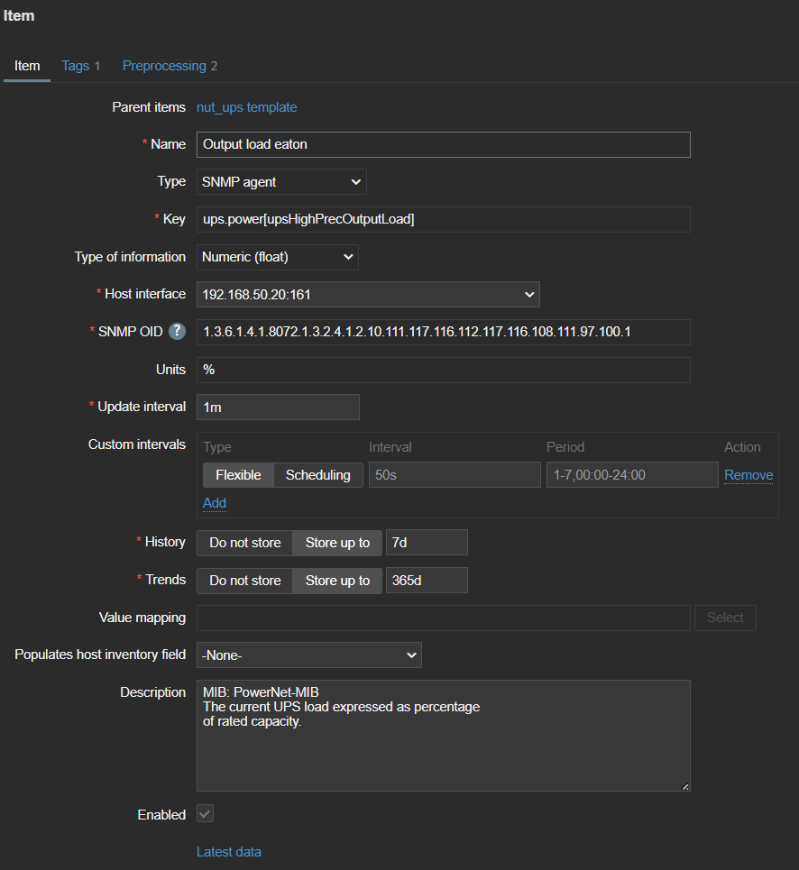

    im a new user in zabbix 7. Now i have add some hosts with templates and it works.
    One of my devices is a ups eaton1200 on raspberry pi with installed nutdev.
    Now i have read the snmp-data via snmpwalk and create new items.
    Some itmes work fine and updated automaticly every minute, but some items does this not.

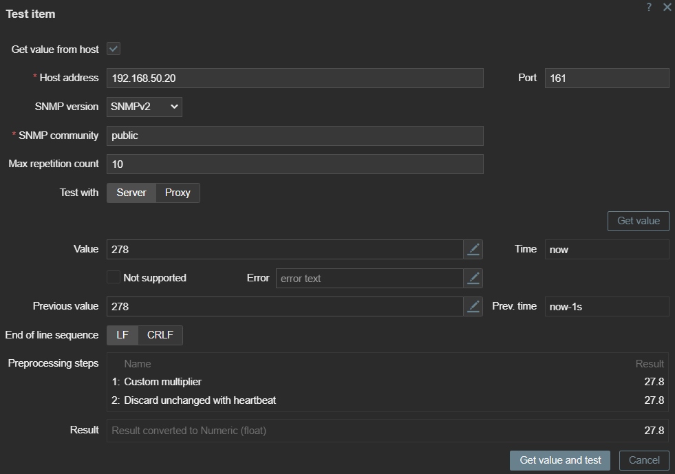

    If i test the item (item -> Test -> Get value an test), then i can see the correct data.
    i have set the Update interval to 1m, 2m, 5m, the Custom intervals to flexible with fixed
    timesettings, restart services, reboot zabbix - nothing works. What can i do? Can anybody helps?
    E.g. you can see Output frequency eaton (this doesnt work) and Output load eaton (that works).

    What's under preprocessing? "Discard unchanged with heartbeat" So, do not expect the value to change more often than "Heartbeat"..
      • 4993
      • chipmaster
        • Jun 2024
        • 9
        your the best...thx
