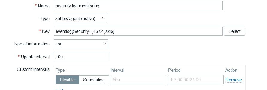

          here is screenshot of what setup in items.

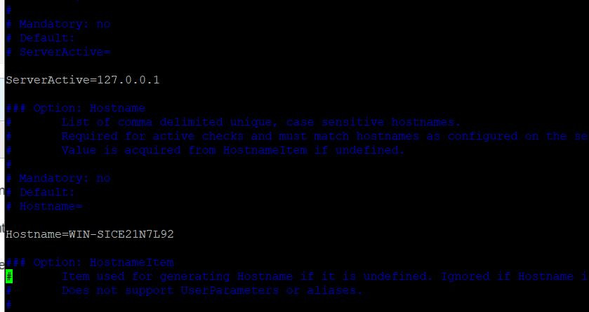

          i have only two node on my zabbix , server itself and a windows server , here is snapshot of what i entered in config file
Name:	active check.jpg

            You didn't answer my question, I see.
            How is it possible that your Windows host has "ServerActive=127.0.0.1" (= localhost)? There is no Windows version of Zabbix proxy or server.

                  You cannot use eventlog item in the Zabbix server, because Zabbix server is only running on Linux (etc), and the eventlog item is only available on Windows version of Zabbix agent.
                  Reconfigure your Zabbix agent on the Windows host: set ServerActive to the IP address of the Zabbix server. That's how the agent understands where the Zabbix server is so that the active items can work.
                  Then ensure that you configure the eventlog item for the Windows host, not for the Zabbix server host.

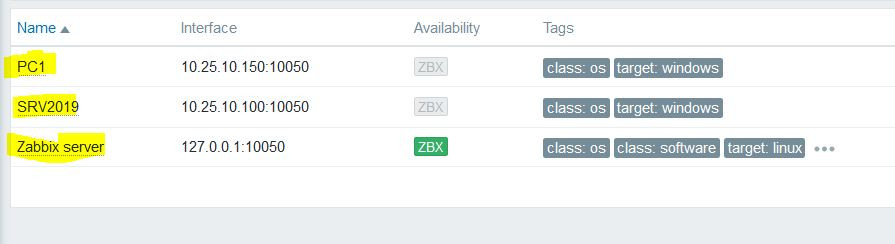

                        i just renamed my windows server to make sense , here is the screenshot. my server is "Zabbix server" and ip address is 10.25.10.175
                        windows server : SRV2019 ip 10.25.10.100
                        Windows 10 PC : PC1 IP 10.25.10.150
                        and here is config file on zabbix server , if i want to monitor 100 server or device which need active check , should add all names manually ?
