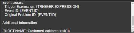

          {PRDLOGSVR1:CustomerLogName.last())} I tried multiple variations to try to get this to print the value tstdoc
          What is the correct syntax to do this, please help :-)

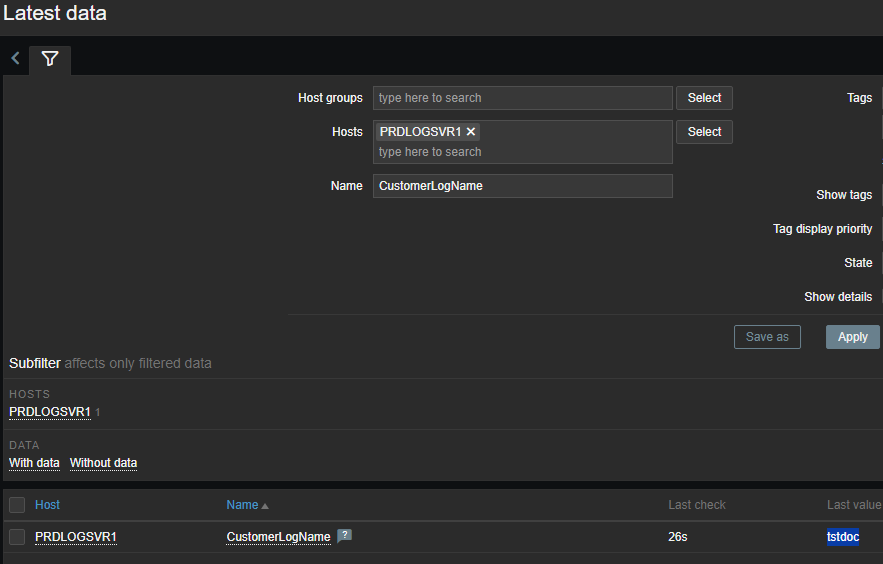

          Here is a screen shot of the latest data: as you can see it has a value of tstdoc

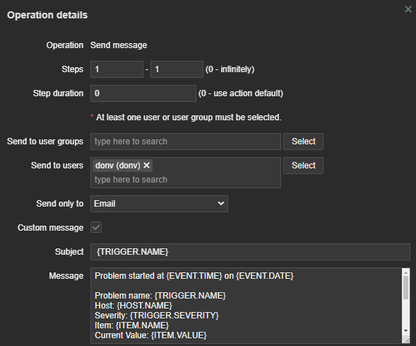

          My trigger email definition looks like this:

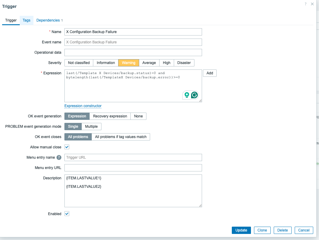

            Did you ever manage to do this? I want to enrich the description with another item related to the host. This will then give the operator further context, without manually checking on the host.
            • earth-spark
              • Jun 2025

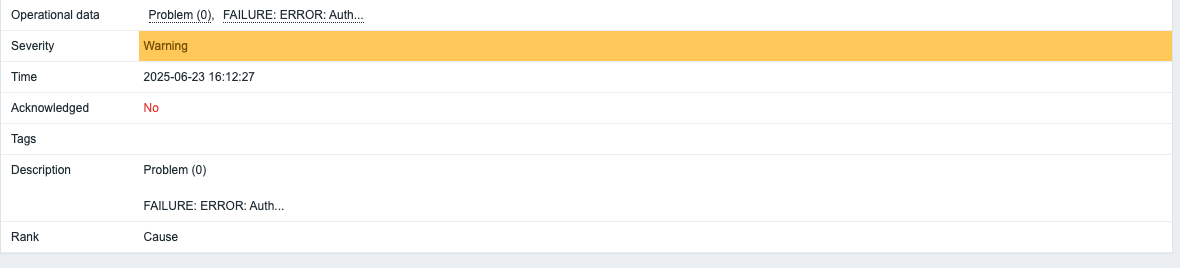

              Some further context: I have two traps being sent via Zabbix Trapper.
              One is a numeric value; the other is a string value.
              I want to display the string within the problem description to give more context for the agent. An example of the string being passed:
              FAILURE: ERROR: Authentication failed for A.B.C.D. Details: 401 Client Error: Unauthorized for url: https://A.B.C.D/mmi/api/jsonrpc
              I can only seem to reference items utilised in the expression, so I included the value within the expression even though it's not required to identify the problem.
              Even doing this, the string is truncated in the description.
              See both the Trigger and Problem screenshots.
              Click image for larger version  Name:	Trigger_Screenshot.png Views:	0 Size:	79.6 KB ID:	504391
              Click image for larger version  Name:	Problem_Screenshot.png Views:	0 Size:	21.2 KB ID:	504390
              Is there a method to show the full string received within the description of the problem triggered?
              It's not the best fix; however, I could patch /usr/share/zabbix/ui/include/items.inc.php—so true $trim = false is false.
              function formatAggregatedHistoryValueRaw($value, array $item, int $function, bool $force_units = false,
              bool $trim = false, array $convert_options = []): array {
              $units = $force_units || CAggFunctionData:reservesUnits($function) ? $item['units'] : '';
                Originally posted by markfree
                Look at the expression macro syntax at the link above and try using it. This seems like a good approach.
                but you can still only use those items and values that you are using in trigger expression... If expression only uses CustomerLogErrorID, then you cannot use CustomerLogName. So, to have a name also available, you can add another (useless) equation to expression ... like bytelenght(last(host/item))>0 and then you can reference that items value in your event name.
