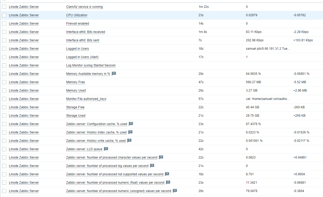

    Does anyone know why my macro labels are not working?
    I tried restarting the server, restarting the proxies (to update the items) restarting the agents on the host.
    I also upgraded from zabbix 6.0 to 6.4 and there is no change.
    after the upgrade, i also restarted the server, proxies and the agents.
    This is happening for all my pfsense routers and the zabbix server (pictured) I have not tried for any other host, but this ones are the ones I need this for.
    Any suggestions on what to do or things I should check for?
    As you can see all the items are configured and working properly.
    Thanks.

      I am not sure what the issue was, but this is what I currently have and it works:
      {HOST.HOST}
      Memory Available: {?last(/{HOST.HOST}/vm.memory.size[pavailable])}
      CPU Load %: {?last(/{HOST.HOST}/system.cpu.load[all,avg1])}
      Uptime: {?last(/{HOST.HOST}/system.uptime)}
      You have to have the same items assigned to the server in order for it to work.
      if you remove the vm.memory.size[] item from the server, it stops working.
      Hope this helps.
