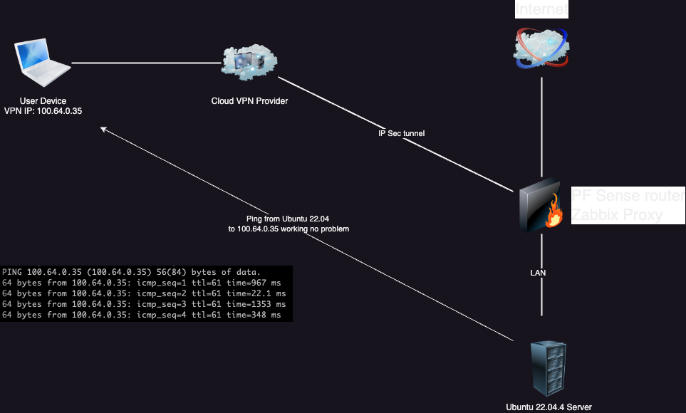

    I attached a drawing of the current configuration, showing a succesfull ping from the Ubuntu 22.04 box to the Client Device (100.64.0.35)
    I can succesfully Ping from the Ubuntu 22.04 serer to the User Device 100.64.0.35 (This is being routed via the IP Sec tunnel)
    Click image for larger version  Name:	Zabbix Probleem.drawio.png Views:	0 Size:	87.5 KB ID:	486438

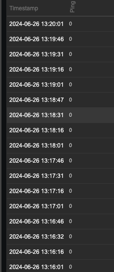

    Click image for larger version  Name:	Screenshot 2024-06-26 at 13.20.34.png Views:	0 Size:	16.1 KB ID:	486440

    icmppingsec is one of the "simple checks":
    Zabbix server/proxy is responsible for the processing of simple checks (making external connections, etc).
    Since your Zabbix server does not apparently have connectivity to the 100.x host, you have to set that host (where the ping item is configured) to be monitored by a proxy. Then that proxy will make the ping connections.
