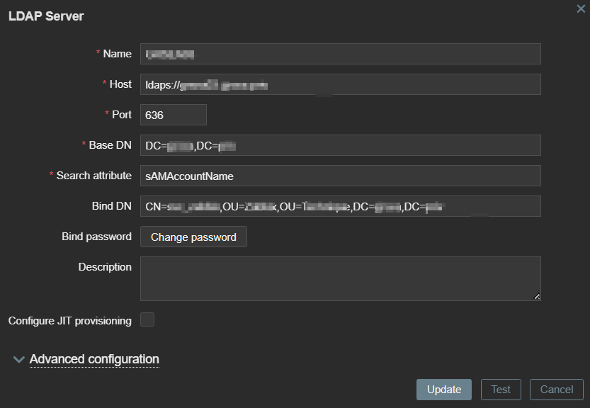

                • ZATA45
                  • Jul 2024
                  Hello, my LDAPS It's working now in zabbix 7.0.3 !
                  Configuration :
                  Host : ldaps://company.domain.com
                  Port : 636
                  Base DN : DC=domain,DC=com
                  Search attribute : sAMAccountName
                  Bind DN : CN=serviceaccount,OU=Zabbix,OU=Technique,DC=domain ,DC=com​
                  LDAP.conf :
                  SASL_NOCANON on
                  TLS_REQCERT allow
                  Thank's all for your answers !
