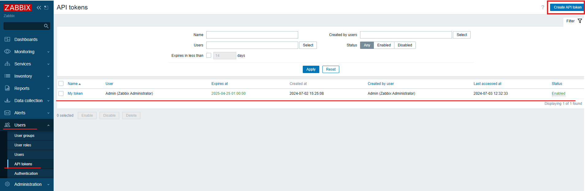

                      1. Create an API token and don't forget to save the token ID as you will need it later

                      2. On your server log in and make a file data.json e.g. nano data.json and copy the bellow contents
                        	"jsonrpc": "2.0",
                        	"method": "host.get",
                        	"params": {
                        	"output": "extend"},
                        	"id":1
                      3. make a curl request:
                        curl -k --request POST \
                        	--url 'https://10.143.1.153/zabbix/api_jsonrpc.php' \
                        	--header 'Authorization: Bearer 01d32e8b2f5089591b3dd091998b7060770ed5844466ae9ae4084c951233be18' \
                        	--header 'Content-Type: application/json-rpc' \
                        	--data @data.json >> hosts.json​
                        Authorization: Bearer - you need to put your TOKEN API id
                        --data @data.json >> hosts.json - from data.json file which you have made on step 2 it will put all output to a file hosts.json
                      4. And then with python and pandas I convert hotst.json to csv - link for tutorial https://learnpython.com/blog/python-json-to-csv/
