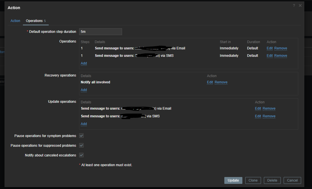

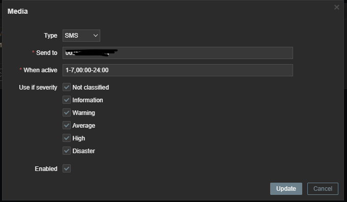

    I have configured the following SMS integration (https://www.labsmobile.com/en/sms-ap...modules/zabbix) but it is only working when I manually trigger this from ssh so when I do so I am able to receive an SMS. Now If I configure a trigger action to send an SMS on alert it does not work.
    I do have an email alert which works but funnily enough (not sure if it's how it should be) if I add the SMS media as another Operation under trigger action the email does not work either. I did try to disable email completely and allow only SMS but that does not seem to work either.
    Any feedback would be much appreciated as I can't figure this one out. Thanks!

    I just managed to make it work! I found someone on this forum with a similar issue, 4 years ago and basically what I did, I added again the SMS media type to the user where you add the recipients number, then all I had to do was go back to trigger actions, add the operation to send the SMS and finally, what i did not do before was to disable the trigger and re-enable it.
    Problem Solved.
