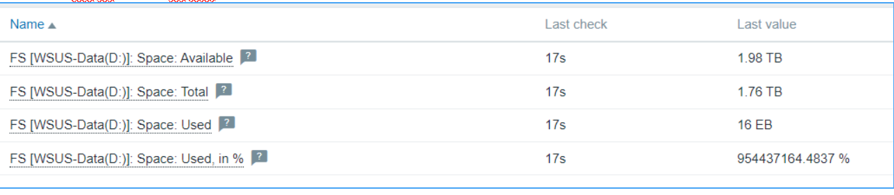

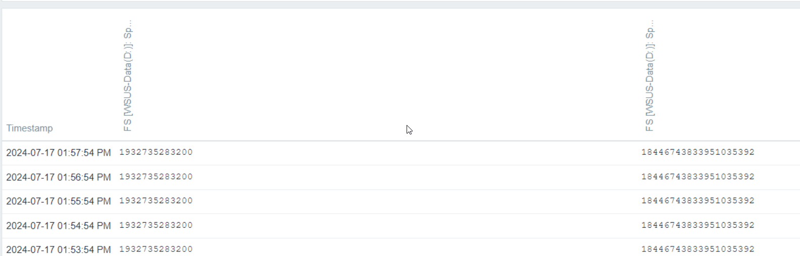

    Hello everyone,
    of our 120 or so Windows servers, one has a problem with the vfs.fs.dependent.size item from the Windows by Zabbix agent active template.
    We´re using the 7.0.0. Agent.
    A Screenshot with the Total and the Used Value:
ID:	487668Click image for larger version
    The trigger probably almost rolled over during the check.
    Does anyone have any ideas?
    I have already performed a restart (which really helps sometimes).
    Reassigning the template (the old data was deleted) did not help either.
    Partition D still has an extreme value.​

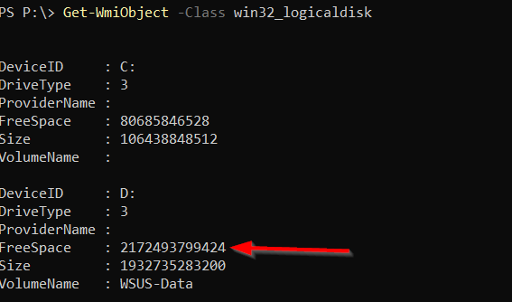

            Ok.
            Zabbix is not the Problem..
            Very Strange..
            • markosa
              • Aug 2022
              • 107
              What does Get-CimInstance win32_logicaldisk return? As Microsoft pages state "Starting in PowerShell 3.0, this cmdlet has been superseded by Get-CimInstance." Get-WmiObject (Microsoft.PowerShell.Management) - PowerShell | Microsoft Learn​
              • Daniel4711
                • Jul 2014
                • 127
                Thanks for the tip.
                Somehow get-wmiobject is stored in my brain.
                get-cmiinstance also returns the wrong value.
                A get-psdrive also returns the wrong value.
                A get-volume returns the correct value.
                I am surprised that drive C: is not affected.
