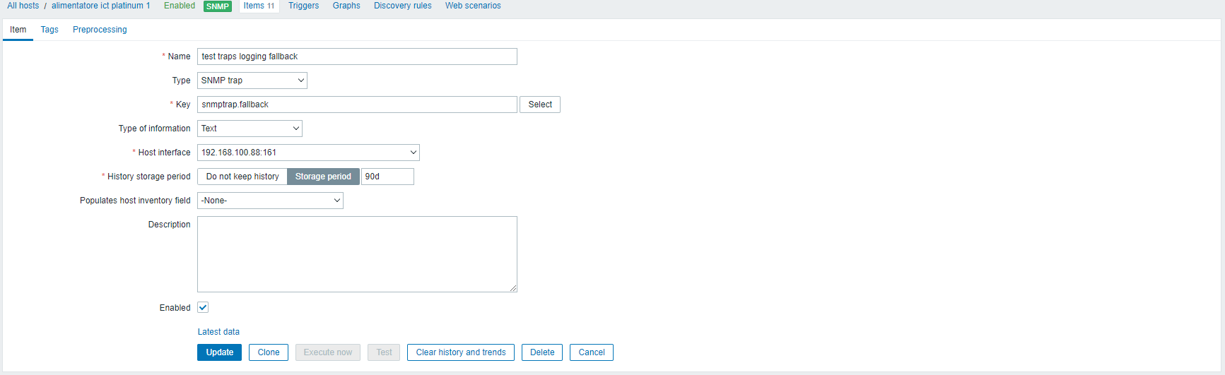

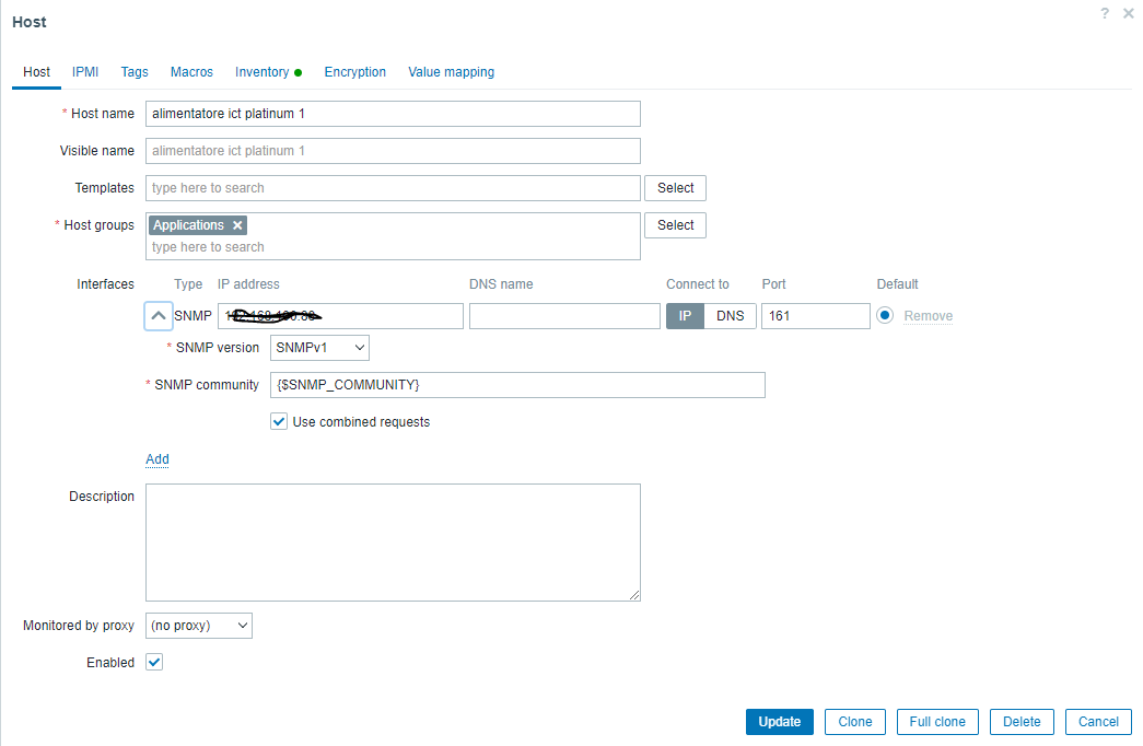

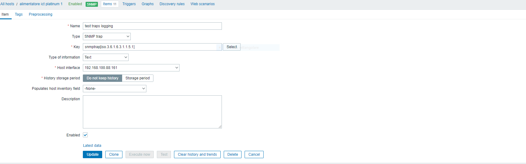

At the moment I've a device mounted into a rack that it's capable of pooling traps ( just the coldStart ) toward my server.

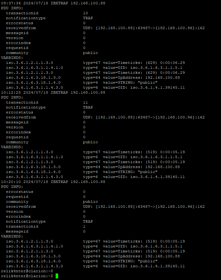

I'm sure about the receiver send traps properly, the log file record them as well.

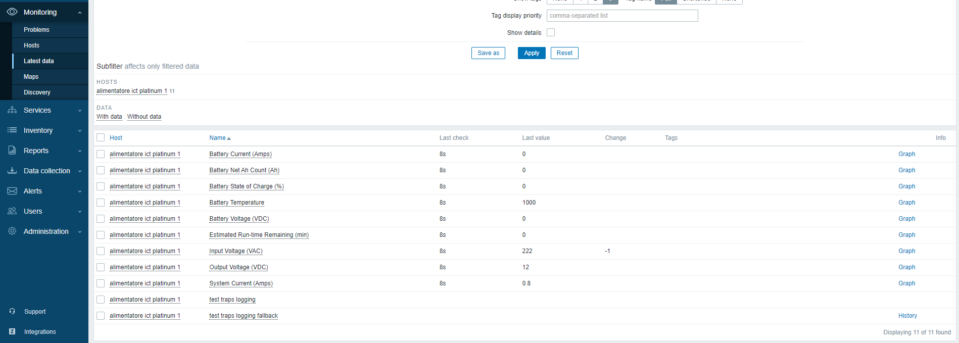

THe problem arise when I want to view them into zabbix Last Data View, where untill now there's no data captured.
Below i try to attach some of my setup.
At the moment i can catch only the ColdStart from the device.
